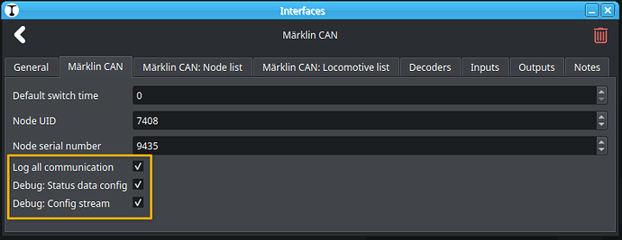

Märklin CAN (MCAN) is supported by Traintastic using the Märklin Central Station 2, Central Station 3, Central Station 3+, or e.g. a CC-Schnitte + Gleisbox setup.
Driving locomotives and switching turnouts/signals are supported. Feedback via the Märklin CAN bus is also supported, although not everything has been tested with every hardware combination. I don’t own all of these devices myself, so testing is somewhat limited.

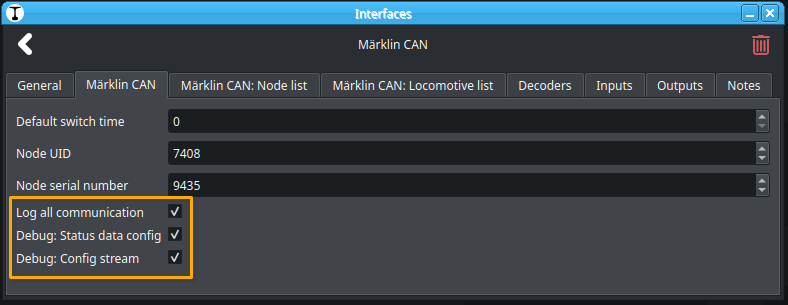

When testing, please enable the Log all communication and debug settings.
This will log all commands sent and received by Traintastic.
Using the Diagnostic Report option, the world configuration, log, etc. can be collected and posted here. This will help with diagnosing issues and improving Märklin CAN support.
