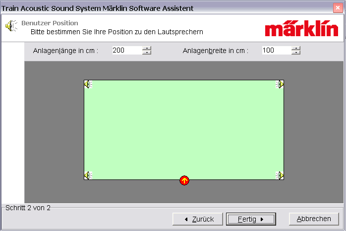

Not all Trains come withs speakers. This Feature could help it my simulating sounds with cordinates. 4 speakers would be used on each corner of the board to simulate the sound in a specific place. This is still inspired by the old Märklin 60128 Software:
It also would allow to simulate other sounds on the board. The best option for controlling the speakers would be just to select an speciffic sound adapter as examle in Windows. Some very thin and long boards could have problems with the sound volume. A fix would be to create a 6 or more speaker mode for this which would work like two normal 4 speaker boards joined togeter. The sounds could be called in code something like that:
