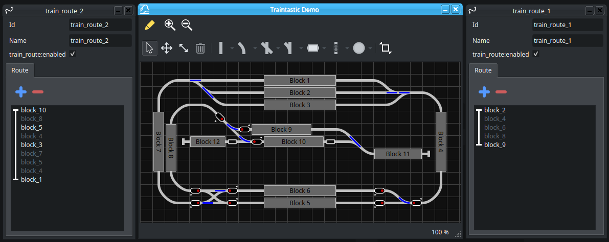

Basic form of routes:
I want to keep the first version simple, just a list of blocks and an optional wait time.
The white text entries are user provided, the gray entries are resolved intermediate blocks. For path finding it uses Dijkstra’s algorithm, for distance it uses path cost.
The default path cost is 1, but every turnout in the path adds 1 for straight and 3 for diverged, changing direction has a cost of 1000. (These costs are just guesses, time will tell what is best I hope.)
If a path can’t be found, the vertical line in front of the block names will have a gap.
For blocks where the train has to wait (e.g. a station) I’m thinking about adding a dot to the line, this will make is visual easy to understand the rout quickly I think.

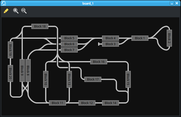

Just made something to play with :slight_smile:
pathfinder 2026-09-25.ctw (2.3 KB)
Other nice thing to try is, create some routes, then alter the board, exit edit mode. The all routes will be updated.

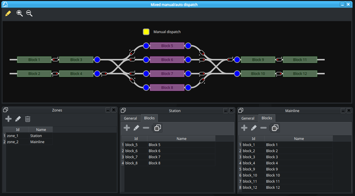

This clear separation of responsibilities makes it easy to support mixed automatic/manual traffic.
Currently all dispatching is automatically, but in the future I’d like to support (partly) manual dispatching as well. e.g. an automatic dispatched main line and staging area and manual dispatched station (using hardware buttons).

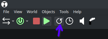

Gave it a bit of thought, what about a block reset option (only UI, not script).
It should give the user a popup to inform what is about to happen:
  • EStop all trains reserving the block.
  • Force release all paths
  • Mark the block Free, unless a sensor says otherwise.
This is a “fix” function, which is useful during development, goal should be that a “normal user” never has to use it. We could add a client developer option for it, so by default it is hidden.

Did some more work on the test layout and AutoThrottle yesterday evening. Implemeting a very basic basic driving routine, hope to test it this evening.
Other thing I found is that worldEvent is never called, because the AutoThrottle object isn’t known to the World currently, so I’ll fix that too.
You need this function if for example you cancel a route but it already has reserved a path. Otherwhise there is not way to release the path without first removing the train.

For the NX buttons my idea is:
By default the Dispatcher handles the path reservations, based on the train’s route. To make it more fun I plan add a manual dispatch option to the zone (changeable at runtime using a switch or Lua). When a zone is in manual dispatch mode, the user has to dispatch using NX buttons. The mainline can still be in auto mode, so the dispatcher will handle that.
This will allow mixed manual/automatic train driving and mixed manual/automatic dispatching :slight_smile:
For NX buttons this will mean they are only active if at least one adjacent block is in manual dispatch mode. (this is currently not the case)
For Lua then the same rule applies, for blocks that are in manual mode Lua can set paths. This allows to user to build their own dispatcher and/or do some magic with external hardware :slight_smile:

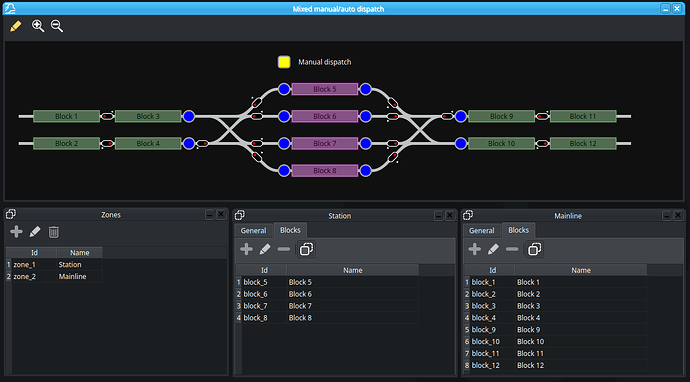

I want to add another traffic control object to Traintastic, the Supervisor. The supervisor will be responsible for validating all traffic control actions: train movements, turnouts, signals, paths etc. These “rules” also apply to the automatic dispatching and auto throttle. By separating the responsibilities mixing all kinds of manual/automatic features should be possible.
This will require “some” time to build and some refactoring, so it will be a multi stage project.
Internally a release path is needed for sure, but I’m not sure if we need it as an UI option. Paths set using NX Buttons can be released by setting the same path again using the NX buttons.
For automatic dispatcher paths, the dispatcher is responsible for releasing them too, this is not fully implemented yet.
