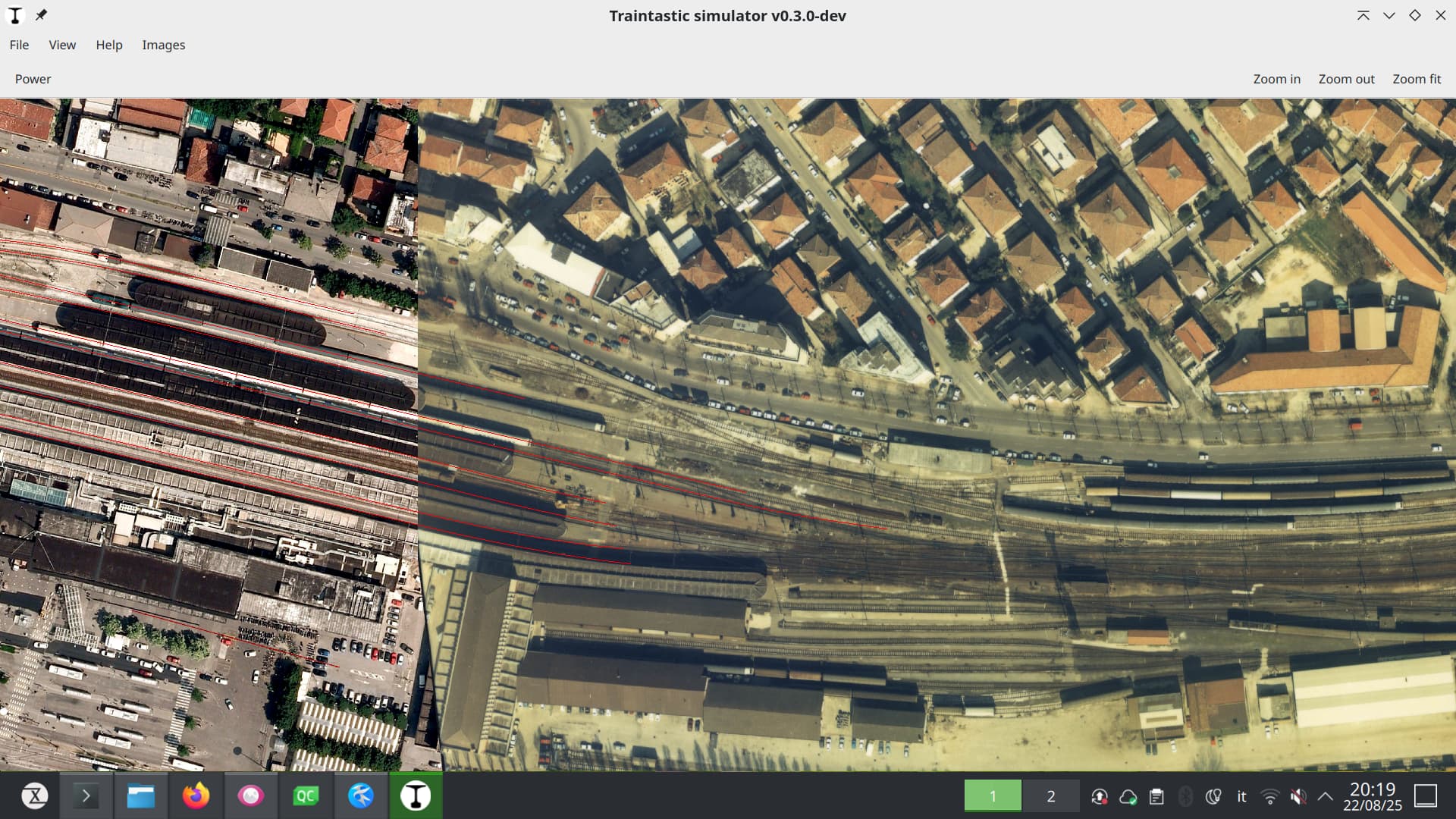

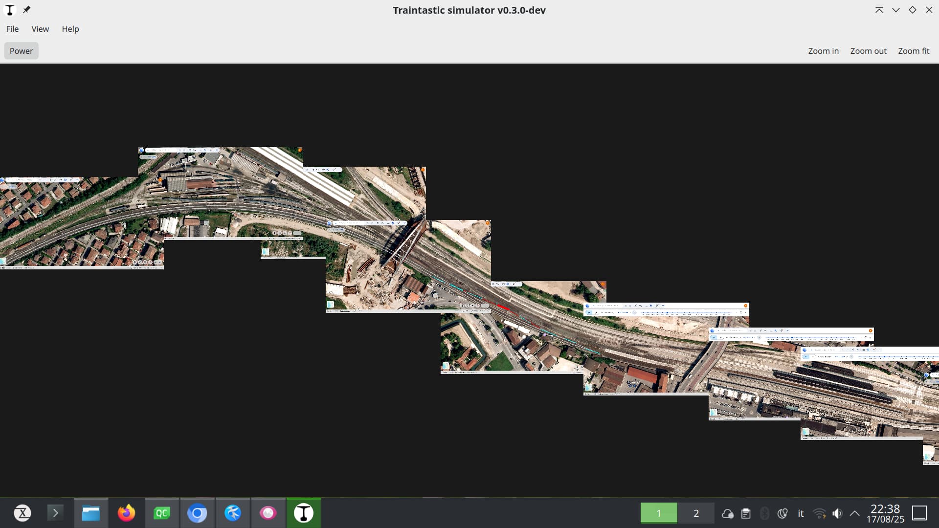

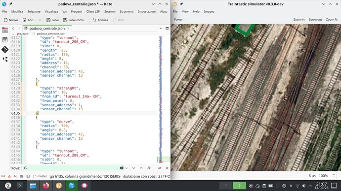

I started by editing traintastic-simulator code to allow image background, then I took some screenshot of google earth aerial imagery.
This was not ideal as the images where low quality and did not align precisely, so I downloaded Google Earth Desktop as it allows to export 8K images of chosen area.
This was much better and with few images I could cover the whole station.
Then I carefully shape tracks on top of these images, this process takes time and is not yet completed!

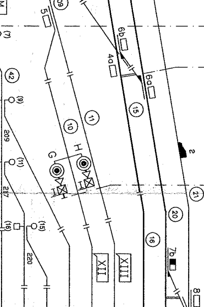

Luckily we have the schematic to help on reconstruct track circuits (you can recognize signals G and H on picture above):

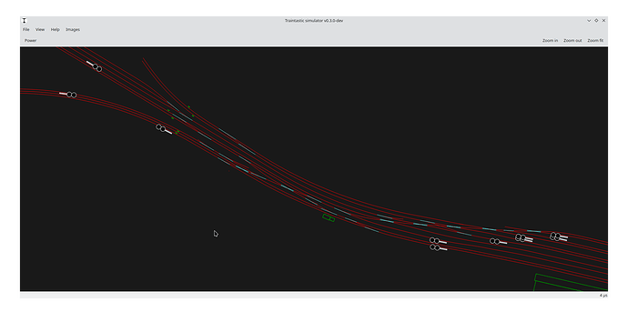

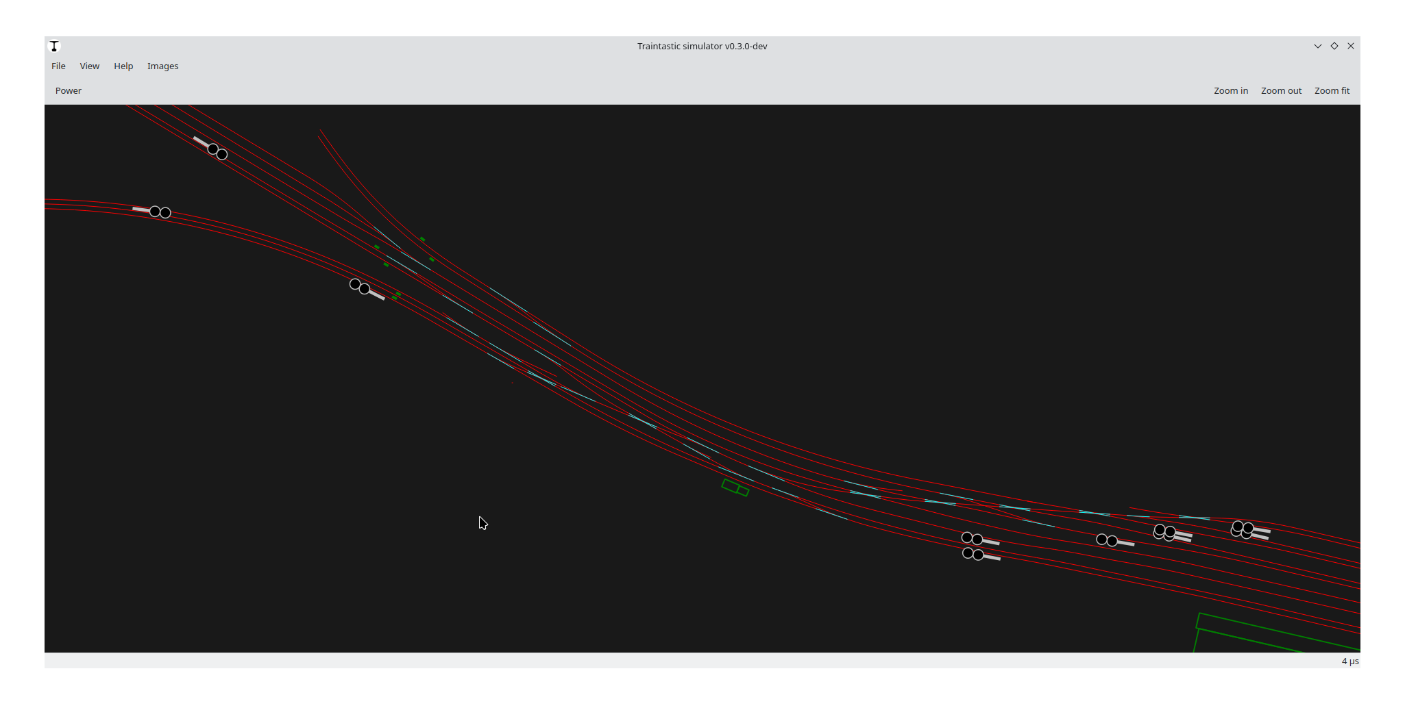

This is west part of central station, controlled by Signalbox A:

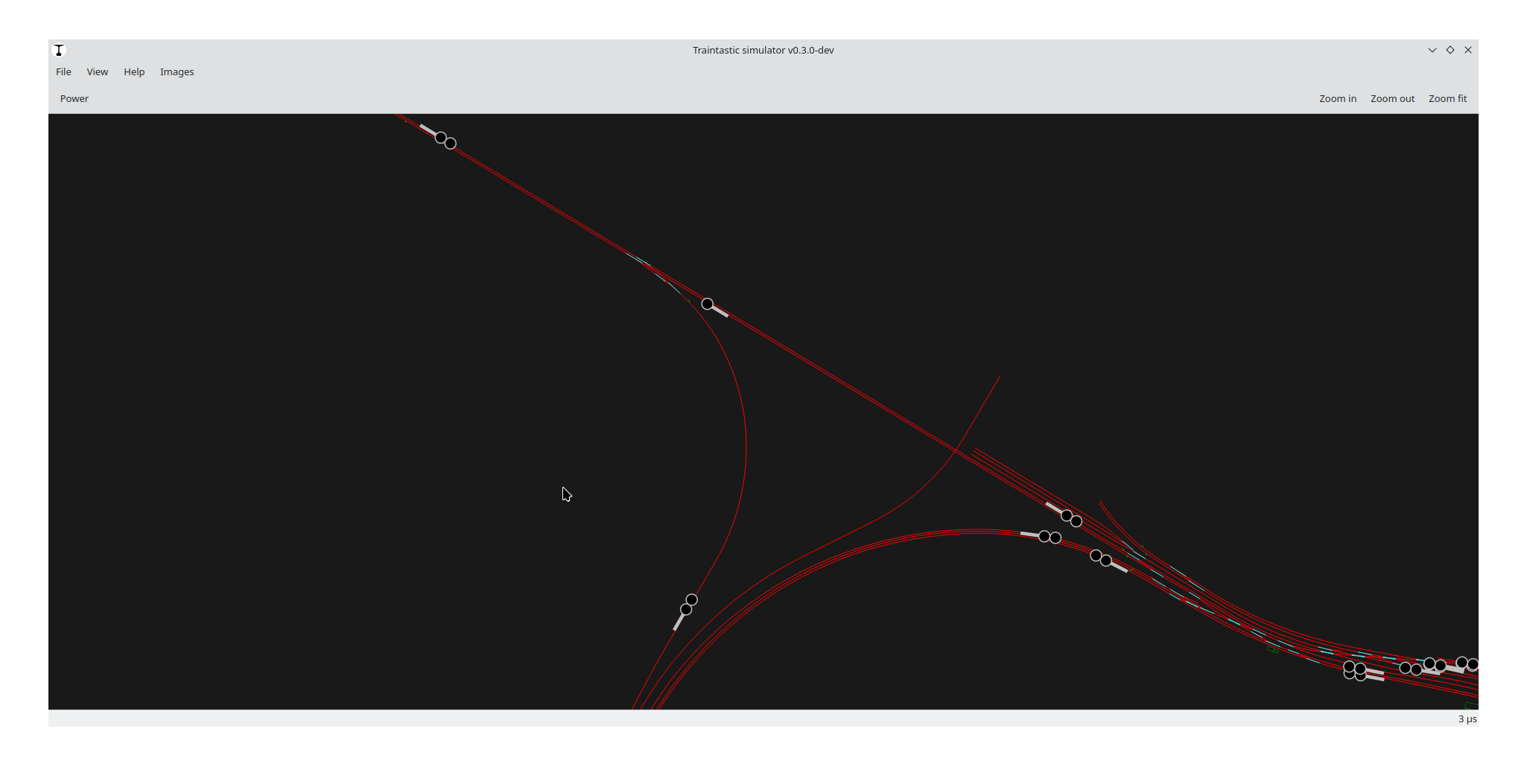

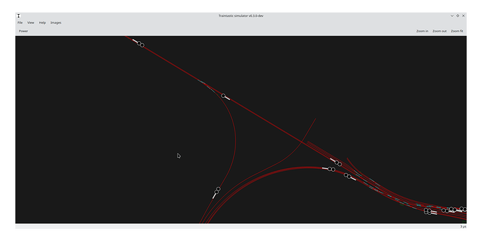

This is Montà junction and the triangle between Padova central station, Padova Campo di Marte and Milan direction:

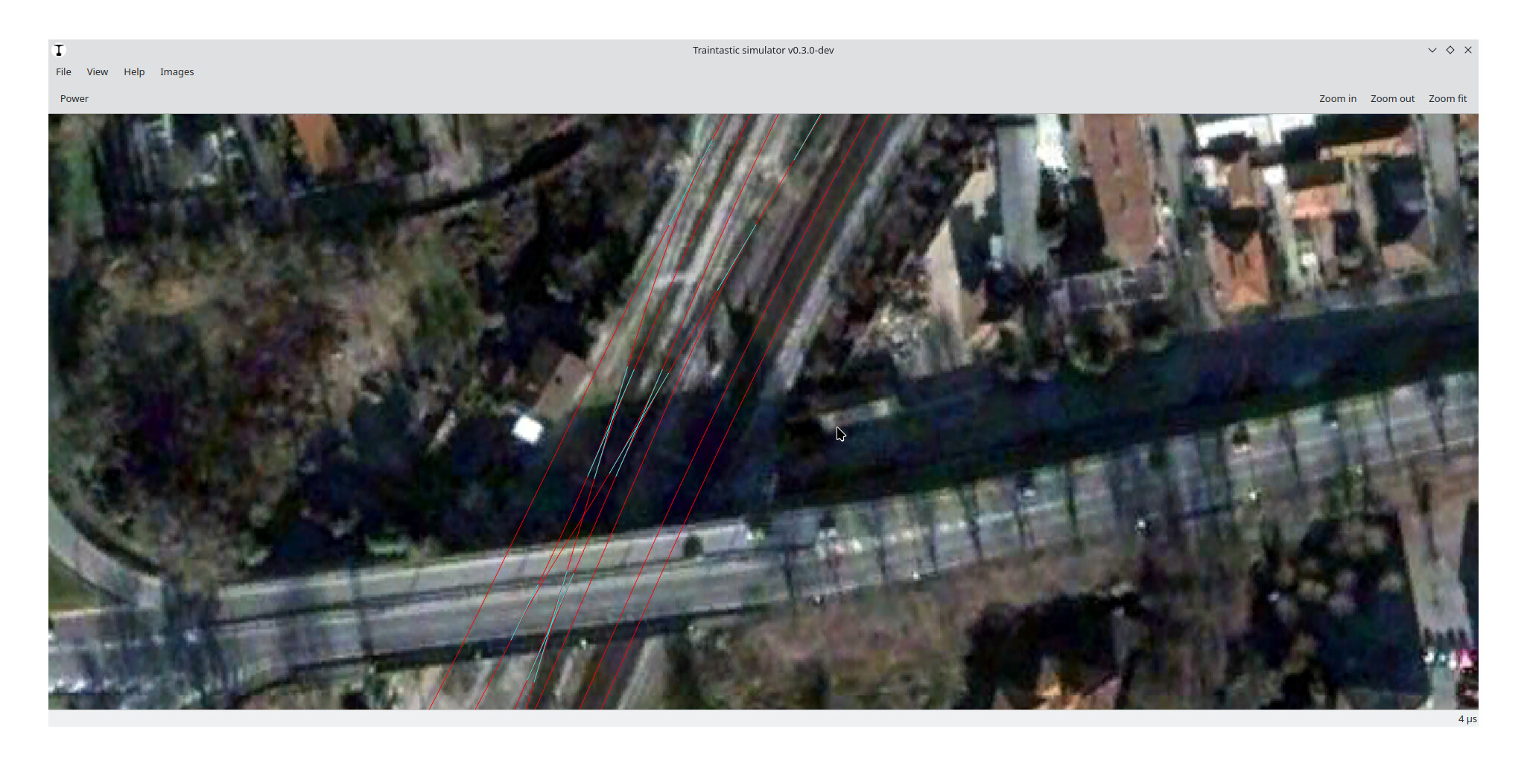

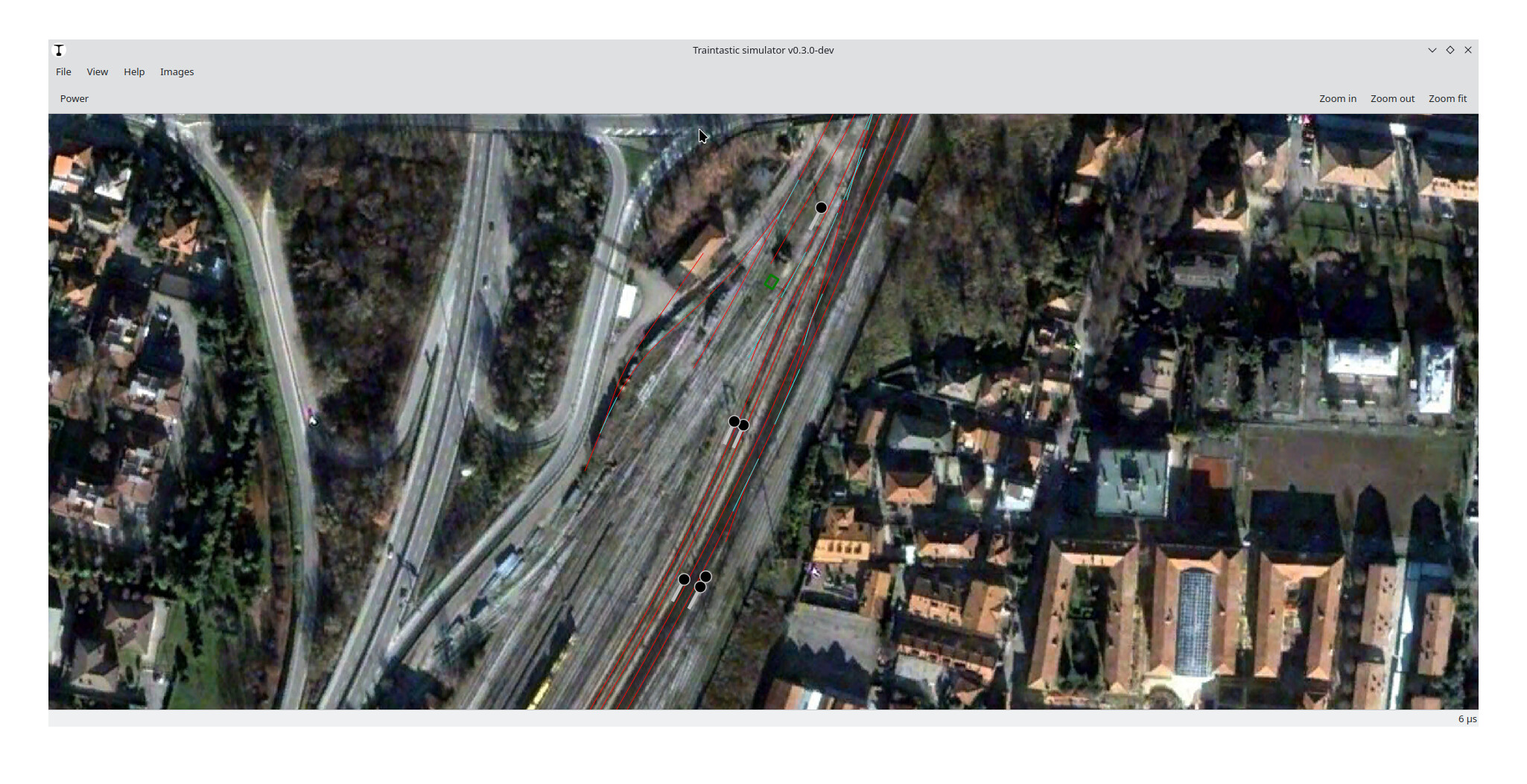

Some other pictures, this was initial experiment with maps screenshots:

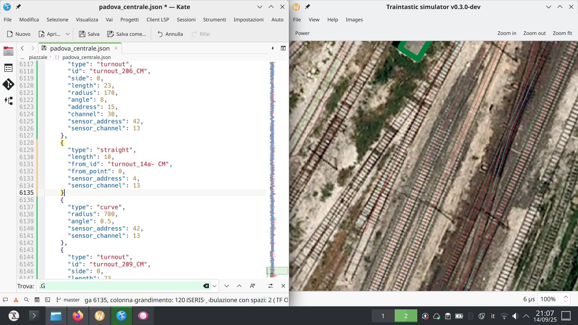

Here is side by side, editing and checking alignment of tracks over background:
Then there are Signalbox B tracks. Since good google earth images are too knew for the epoch we want to reproduce I had to do a collage. Luckily a friend of mine passed me an old aerial image taken in 1987 which I stretched over 2009 images until it fitted decently. Done with Gimp and a lot of patience :slight_smile: .

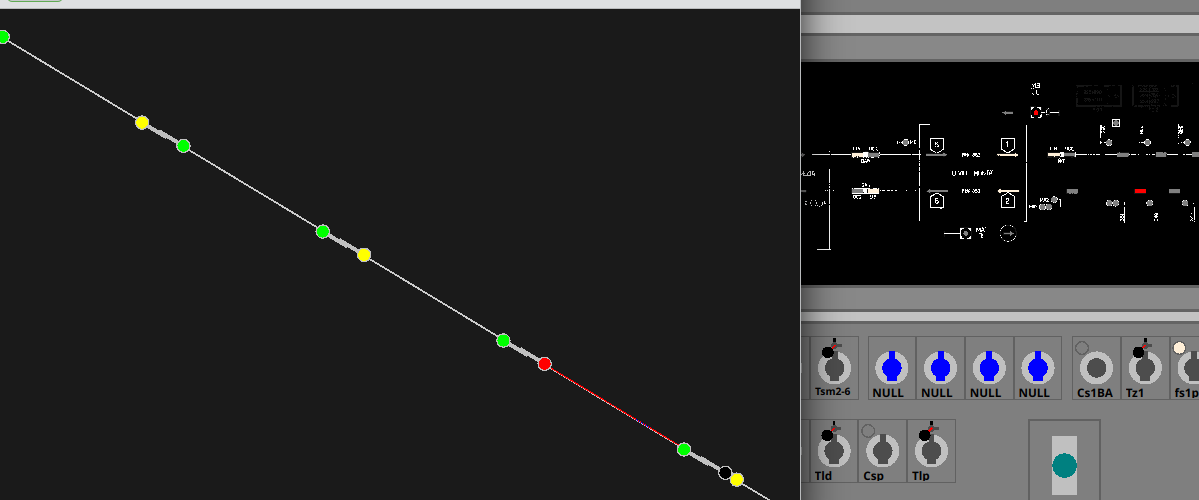

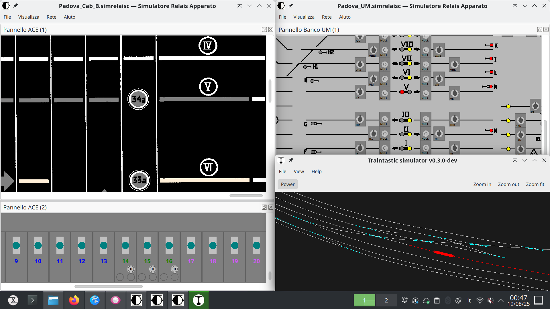

Here you can see the interaction of circuit simulator with traintastic, platform V is occupied by a train an thus shown in red on the station master panel, and with lights off in signalbox B panel:

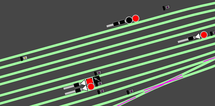

Here is the line towards Milan with working signals commanded by circuit simulator based on track status send by traintastic:

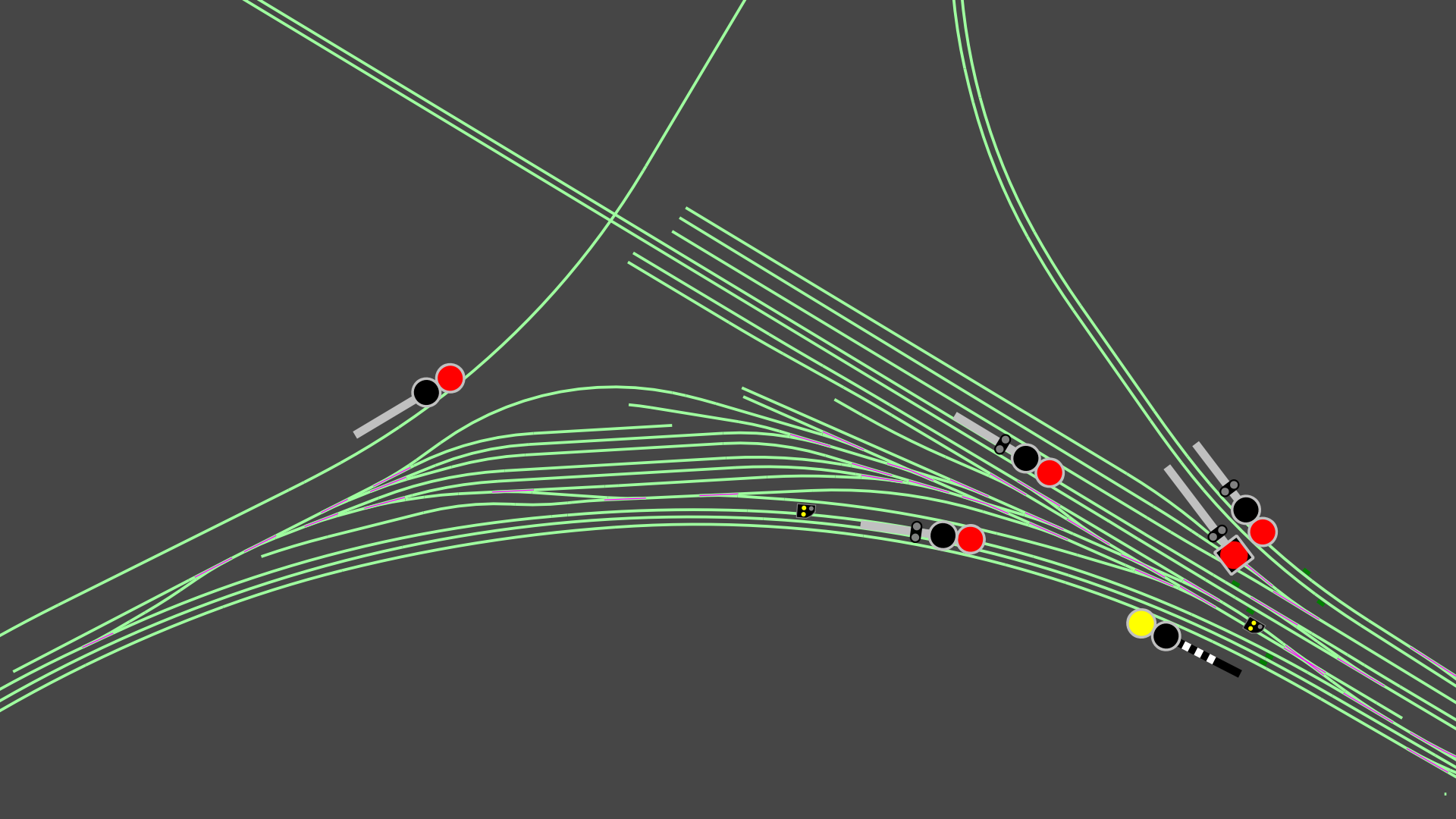

January updates:
Padova Central station is almost complete! Goods yard is the last step.
But I’ve made the locomotive shed and it’s super cute :slight_smile:
You can see the line towards Padova Campo di Marte (bottom left corner), towards Milan (upper left corner), towards Vigodarzere (upper center) and of course Padova Central Station which is on the bottom right!
The locomotive shed has 2 exits, one towards Padova Central Station and another (now demolished) towards Campo di Marte.

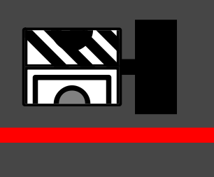

There are 2 dwarf light signals. And you can also see Campo di Marte distant signal which can only show yellow or green in different combinations but not red.
In fact it’s mast is black with white stripes instead of gray of the other signals!
Dwarf signals will need to get input from the physical relays to know when they should change aspect like it was done for B main signal (the red one coming from Campo di Marte).

Hello everyone! I did some work on simulator code, now if a train approaches a turnout which is set to a different route it will stop immediately and also it will break the turnout. So the electrical interlocking will loose position control for the turnout and inform the station master with a sound alarm and blinking turnout light.
In this short video you can see path has been set for XII platform but a train accidentally departs from platform XIII going towards turnout D9.
output
We’ve also improved Arduino circuit by replacing breadboards and dupont cables with PCB and screw terminals. Also power source is now dedicated so it does not get influenced by noise of big relais.
It works reliably so we use traintastic simulator at our public openings to simulate train moving!
