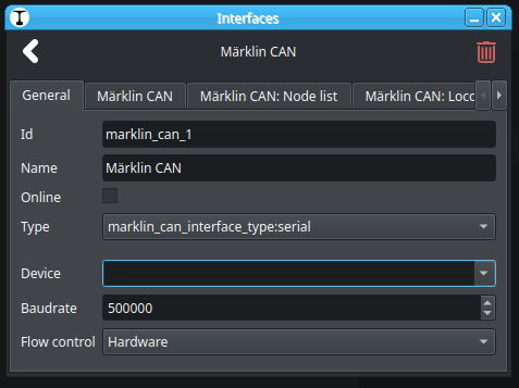

@Zasig I just read the CC-Schitte 2.x interface protocol description, it uses the same format as what is used for the CS2/3+ on the network and … I also made a serial port version back then, so I think communication should work.
I think these settings will work:
If that works I’ll add CC-Schnitte to the type list and hide the fixed baudrate and flow control settings, that will make it easier to setup ![]()
