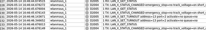

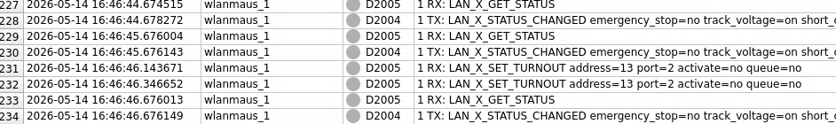

is the switching off turnouts and signals with the Z21App as Wlanmouse not implemented? I see the command in the log, but it will not send out to a DCC-Ex.

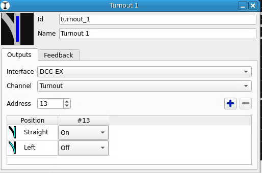

I set in the Z21App a turnout to address 13.
No that isn’t implemented (yet), only locomotive control and track power. If there is a demand I can look into to.
For some digital systems a fake/pseudo address is needed, e.g. with CBUS/VLCB we need to map a (DCC) turnout address to a turnout object in Traintastic for sending the correct event(s).
