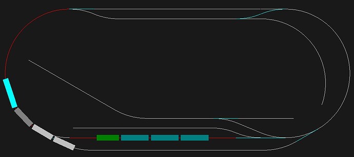

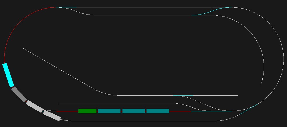

According to your advices, I created a json file describing my layout. It works fine with the simulator. I can change the turnouts, drive each train all around, using keyboard arrows …
I installed both files for windows from fork #185, buid 1767 updated on 2025-12-07.

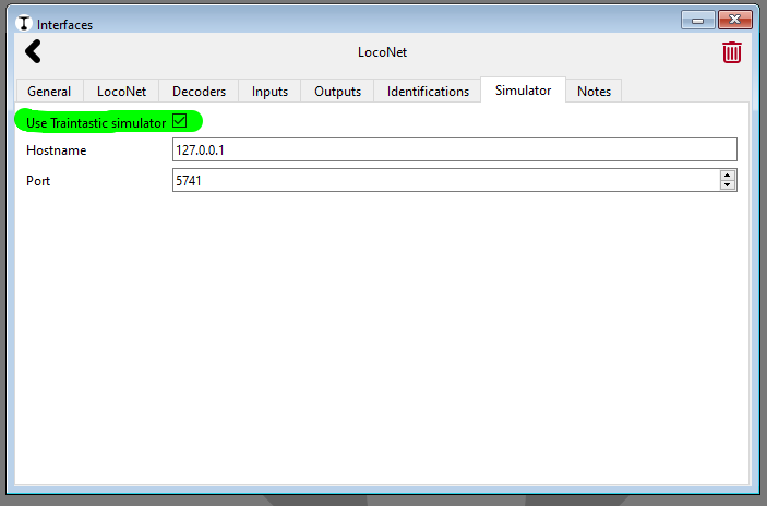

But now the question is : how do I link the simulator with traintastic server ?
I started Trainstatic server, then trainstaic client and the simultor.
In edit mode in the client, I went to the interfaces menu, I selected DR5000 ( offline as it is switched off), in the simulator tab I checked the “use simulator” chekbox, with hostname “127.0.0.1” and port “5740” (default values).
Going back to run mode, nothing happened, even when trying to start a train with the embedded throttle.
I think I missed something, but what ?

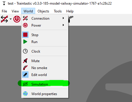

Did you check this?:
And put the World in simulation mode?:
After that you can put press online and it should connect to the simulator.
If not please let us know :slight_smile:
Regards,
Thank you Reinder
I missed the last step “put the word in simulation mode”.
Now it’s Ok, I can control the train in the simulator using the trainstatic client embeded throttle.

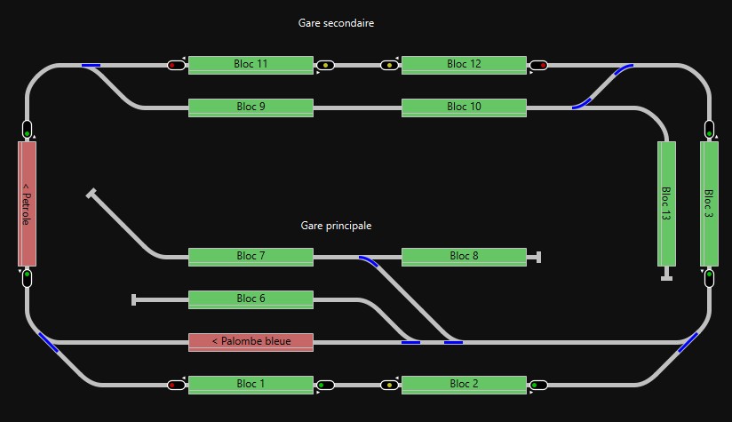

Relying on your help, now I have a full connexion between the simulator and the layout in traintasic client.
The throttles linked to a train in the client, control the trains in the simulator. A click on a turnout in the client switches the turnout in the simulator. Occupency sensors status, from the simulator, are reported into the layout and train moves from block to block are reported. It’s working fine. The input monitor helped a lot for assigning sensors to blocks.

With your help, I’m going on with learning LUA scripting. I had a lot of fun, writing scripts and using the simulator to test them.
I got a train shuttle going from one block to the other around the layout. But due to the very low acceleration and deceleration rates, I have to start braking three blocks ahead the arrival block, and reduce the speed of the train to 25 km/h all over the layout. In scripting, it adds lot of complexity. As you proposed in an earlier post, is it possible to have a way to settle those rates ?
I try to use signal tiles as they take into account the turnout states and the occupency of next blocks. But to reach such a behaviour, I had to set for, the signal tiles, the option “require_reservation” to no. Can you tell me what this option is for ?

Here a capture of my layout :
And here a capture of the simulator screen :
For debug purpose and showing the state of the script, I put at least one “log.debug” line per “on_event” subroutine. I suppose that they are time consumming like printf in C langage.
After removing all those lines, there is no more duration warnings.
Regards
Serge

with two trains going around in the simulator, displaying on client throttles the same speed (40 km/h), one is going faster then the other in the simulator. I think it’s relative to the train max speed. If max speed for train_1 is 80km/h and 120 km/h for train_2, I have to set train_1 throttle on 40 km/h (for example) and train _2 throttle on 60 km/h to have both trains running at the same speed.
My physical layout is not available for the moment, so I can’t discrminate if it’s the simulator or the client which is not taking into account the different max speeds.
It is caused by the simulator, Traintastic converts speed/speed_max to the decoder speed step. However in the simulator the maximum speed of each train is the same, so that’s the issue. I’ve added a train speed_max property to the simulator JSON, default is 10.0, so if you set one train to 8 and the other to 12 it should work. The fix is available in Build #1927.
when I switch turnouts from the client board window, the simulator is synchronised and turnouts switch to the same position on both windows. When I switched accidently turnouts into the simulator, the client board window turnouts switched also but to the opposite position.
I’ll need to investigate, do you have the issue with all turnouts or a specific one? Can you show how you setup the turnout and how it is configure in the sim’s json file? (a world export + simulator json is even better if you want to share that, you can send then in a PM if you don’t want them to be public.)
During my tests, the client windows for server messages saturated at 1000 lines. Is there a way to delete initial lines ?
The default limit is 1000 entries after that the oldest are removed when new ones are added, that’s why the number sticks at 1000, a bit useless, better to hide that number column it has not really a function.
