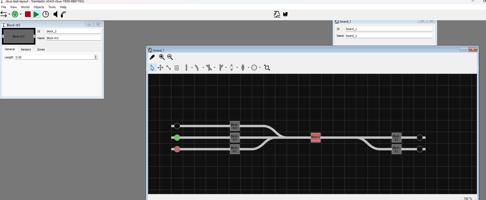

CBUS notes:
  1. The construct node/address feels a bit … weird?
    probably node and event would be a little clearer description?
    i will hook up my jmri instance later and check in FLiM to check
    their nomenclature. Potentially swap node and event [ address today ]
    I use Flim [ windows configuration tool ] to configure CBUS nodes.
    However: until now i used JMRI’s CBUS Hub function to expose that to my
    internal network. Until i get to build my canether.
    or to be honest my current can-ether pcb+ components is damaged → need to order and build a new one :sob:
  2. Exiting without a clear save button feels strange.
    If you had to back out a change because you made an error?
    that is particularly a risk if you have an extensive event list.
    Ask me how i know…
    Hint:
    3 switches
    6 blocks sensors
    5 end of track sensors
    3 switches x 3 events [ trown / mid / closed ]
    and you are already looking at 40+ events over 3 or so boards..
    I am probably being a bit playful but i have seen large Cbus installs
    where these numbers would be on the low side …
  3. I am wondering: you have reed sensor and occupancy detector
    Maybe section and spot detector is covering more?
    section detection for a longer section; Spot for a single short spot
    ( i use mergs’s dtc2 power measurement based for blocks/sections and a bunch of
    InfraRed sensors for spot detection; ie end of track.
    i might change them out for Time of flight or ToTI [ laser based ]
    but that is still spot detection anyway as far as i am concerned )
Lets also celebrate the good stuff:
Sofar both my end of track as well as block detectors [ dtc ] work.
My GUI runs from windows, the backend runs sofar faultless from a separate computer. As far as i am concerned: this is a step forward from previous experiences… Thanks @reinder [ and others ] for making it happen!
@reinder Happy to share the current track and/or the export for my cbus env
