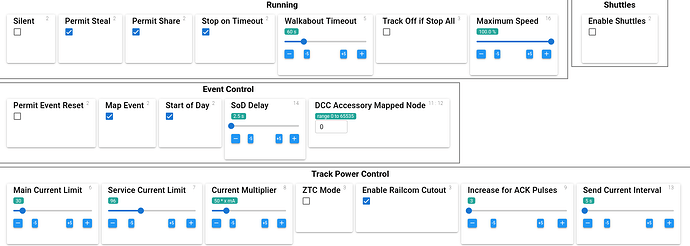

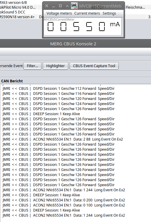

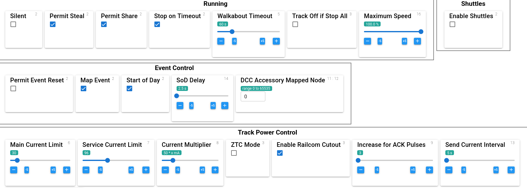

I enabled the CANCMDB to send every 5s the track current.
The current mulitplier is 50.
With JMRI it looks like that:
JMRI  < <  CBUS |  ACON2 NN:65534 EN:1  Data: 0 50  Long Event On Ex2
JMRI  < <  CBUS |  DFUN Session: 1 Range: 1 Fn 18 Set Engine Functions
The message from CANCMDB is a ACON2 with 2 bytes. So I think, the current is 50 x 50 = 250mA. This test I have done with a Roco BR93, ESU LokSound 5. I think the power consumption should be about right. I think the power consumption should be about right; but to really know, I would need to take a resistor and check the current with a multimeter.

The last two bytes are the current. I’m not sure how to convert that. Since I only have estimated values ​​for the loco, I’ll probably have to measure it properly with some power resistory, I should have enough here .

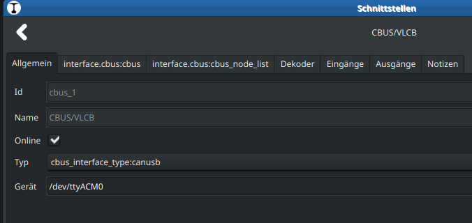

also test this now, but at first:

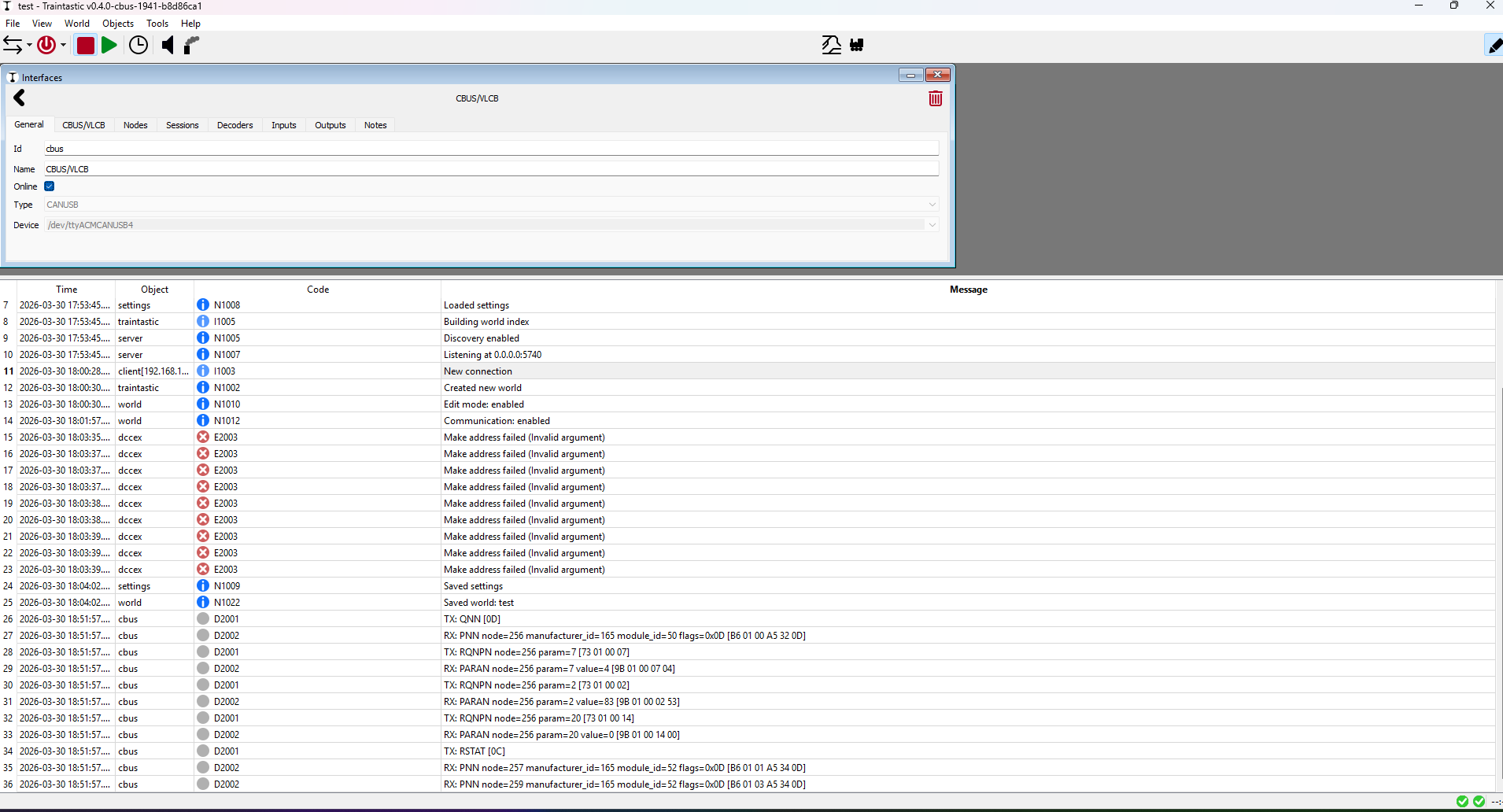

After every new build I have to set the checkmark “Online” again:
Otherwise the server says “bad address” if it tries to open the port.
50x50=2500, that is a bit high…maybe the second by is a fraction. I think we need to dive into the CANCMD source (or ask at the MERG forum) how to read it. Would be nice to show the track current :slight_smile:
Is the “bad address” message in the Traintastic log? If so what is the exact log line?

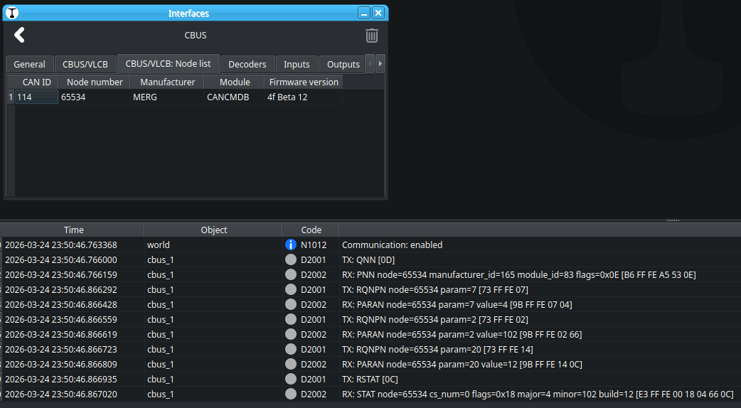

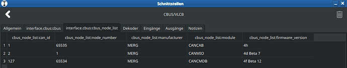

Thanks, any other columns that are useful to add? SLiM/FLiM? CBUS/VLCB node?

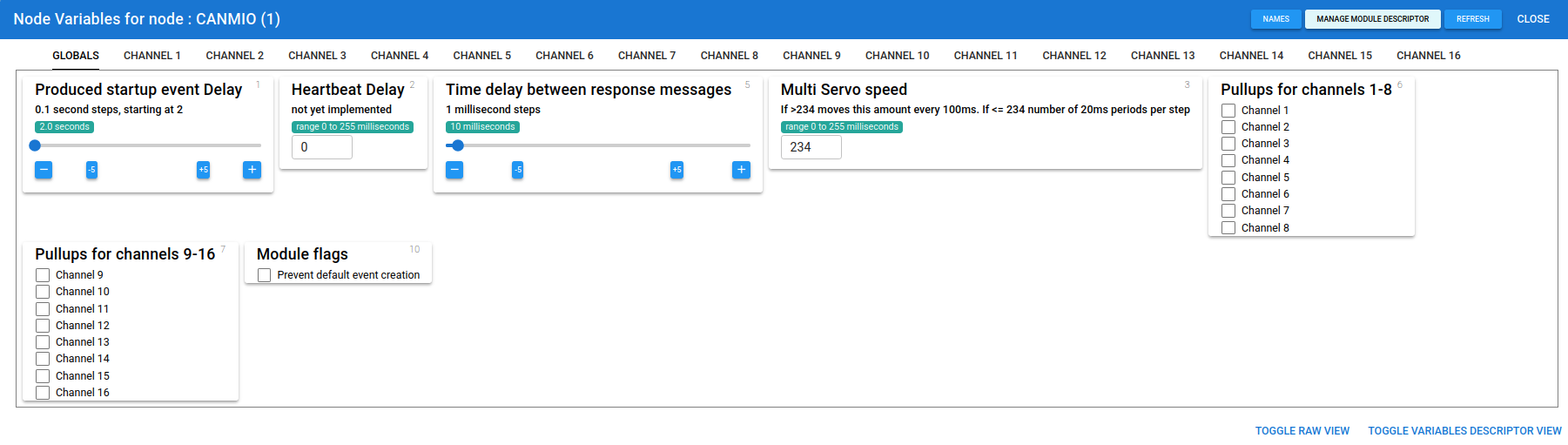

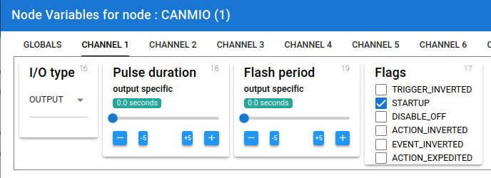

The module configuration is very extensive, that is really cool.

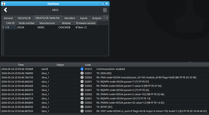

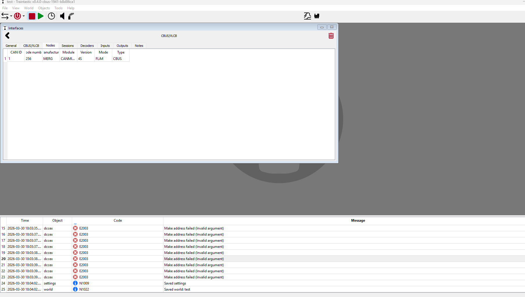

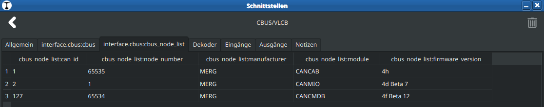

I’ve added two mode columns to the node list:
  • Mode: FLiM or SLiM
  • Type: CBUS or VLCB
@DL7BJ the MMC node list also has Status, do you now how that is requested?

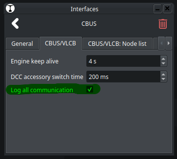

If it works some communication logs would be interesting :slight_smile:

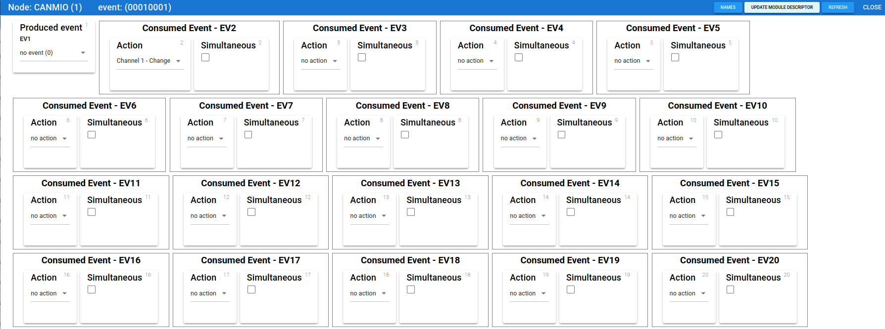

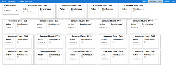

CBUS notes:
  1. The construct node/address feels a bit … weird?
    probably node and event would be a little clearer description?
    i will hook up my jmri instance later and check in FLiM to check
    their nomenclature. Potentially swap node and event [ address today ]
    I use Flim [ windows configuration tool ] to configure CBUS nodes.
    However: until now i used JMRI’s CBUS Hub function to expose that to my
    internal network. Until i get to build my canether.
    or to be honest my current can-ether pcb+ components is damaged → need to order and build a new one :sob:

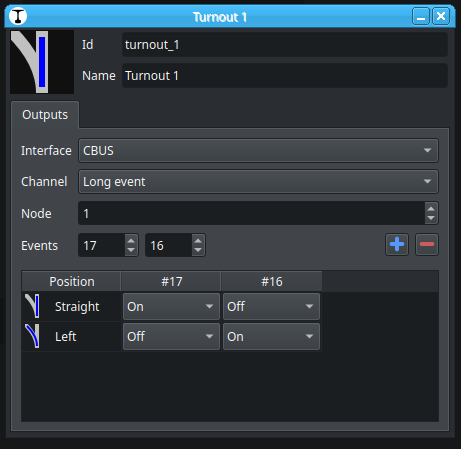

It should look like this, I’ve changed that some time ago:
I wonder why you don’t see it. :thinking:

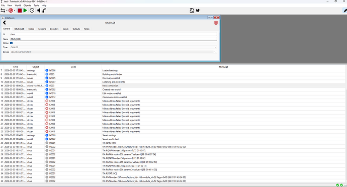

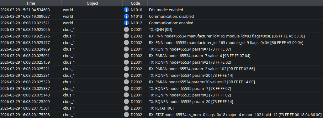

Can you share a screenshot of the CBUS node list, and the log messages regarding node discovery (QNN/PNN)? For that you need to enable Log all communication:
The server log then will display something like this:

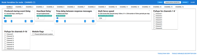

i have configured the 3 way switch and your config is FANTASTIC, allowing to set and unset what is required!
( → to prevent frogs being slightly pushed out of line )
Please mind i only run servo’s so i do not have Tortoises/Seep/Electro magnetics

Which led to the discovery that Traintastic does not want to talk to JMRI/CBUS hub; Flim is working fine via that path tho…
If there is anything i can do to help debug here, please let me know.
After connecting i see only 1 node appear:
That remains even after adding events from other boards.
CBUS is not happy if you go offline for unrelated interface modifications
… required futzing with CBUS → offline → online
Oh the QNN/PNN details:
That’s exactly why it works like that. Good to hear it does its job well :slight_smile:

Can you do the node discovery again?, I need to see the full message timestamps, include the microseconds.
Traintastic CBUS initialization / node discovery work like this:
  • Interface state = Initializing
  • Send QNN
  • Wait for PNN, 200ms timeout
  • If a PNN received, reset set the timeout and wait for another 200ms.
  • If no PNN is received within these 200ms it will continue with reading the node parameters using RQNPN.
  • Wait for max. 50ms for the node’s response, then continue with the next RQNPN until all are sent.
  • Send a RSTAT to query command station status.
  • Wait until STAT, 200ms timeout
  • Interface state = Online
As I can’t see the timestamp it seems the modules response to slow, therefor they are not listed.

Development update:
  • For CBUS/VLCB short/long event input, address is now labeled event.
  • When CBUS/VLCB goes online it now requests the state of all used events.
Available for testing in Build #1943

Before I try to build this version I test another thing, the current meter of JMRI.
MRI  < <  CBUS |  DSPD Session: 1 Geschw 116 Forward  Speed/Dir
JMRI  < <  CBUS |  DSPD Session: 1 Geschw 120 Forward  Speed/Dir
JMRI  < <  CBUS |  DSPD Session: 1 Geschw 124 Forward  Speed/Dir
JMRI  < <  CBUS |  DSPD Session: 1 Geschw 126 Forward  Speed/Dir
JMRI  < <  CBUS |  DKEEP Session: 1 Keep Alive
JMRI  < <  CBUS |  ACON2 NN:65534 EN:1  Data: 2 88  Long Event On Ex2
JMRI  < <  CBUS |  ACON2 NN:65534 EN:1  Data: 1 244  Long Event On Ex2
JMRI  < <  CBUS |  ACON2 NN:65534 EN:1  Data: 0 200  Long Event On Ex2
JMRI  < <  CBUS |  ACON2 NN:65534 EN:1  Data: 0 100  Long Event On Ex2
The data 1 244 are the average of the voltage read by A/D conversion of the controller multiplied by 50 as 16 Bit value, found it in the CANCMDB code. For the main track it use a 0.1R current sense resistor at Sense A (pin 1) of the L298N; I never used this driver and read just the datasheet. The max current for a half L298 is 2A. So the max voltage for A/D conversion can be 200mV. The two bytes are 1 x 256 + 244 = 500 → 500 / 50 = 10. The converted A/D value must be ~10 for 550mA. The A/D converter is a 10Bit, the reference voltage 5V → 10 / 1023 * 5 = 49mV. I = U/R → 49mV/0.1R = 0.49A
For other shunt values the multiplier can be used to adjust the result. I think with all measurement and converting errors, this it is. I hope I haven’t miscalculated again! :wink: :wine_glass:
