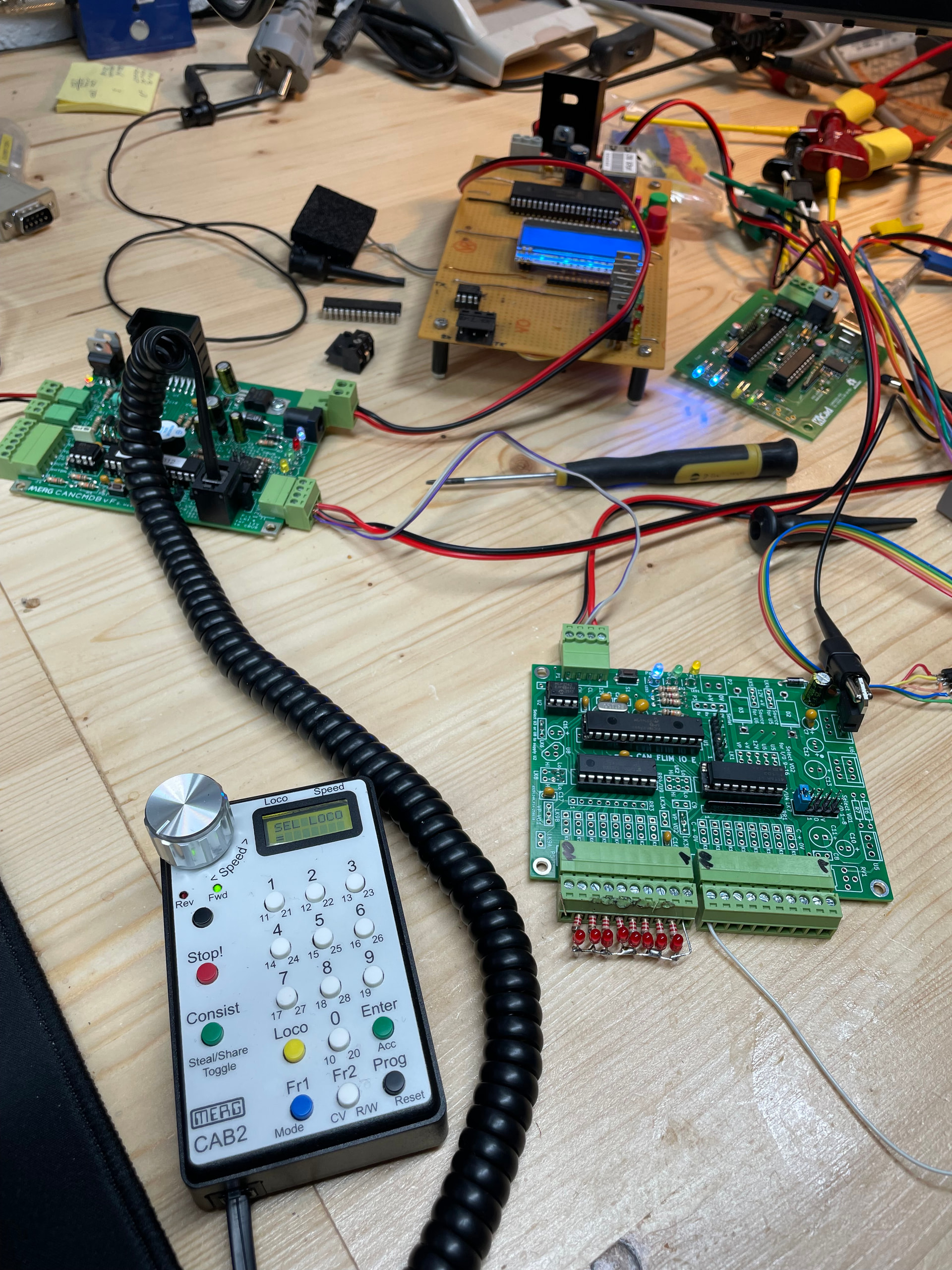

Today I build the CANCMDB and CANCAB. Both kits runs perfect! Just a few minutes ago I test to drive a Loco with traintastic. Light, forward, backward - it runs! Also the CANCAB tolds me, that the Loco 3 is controlled elsewhere - perfect! I’m thrilled!
The CANCAB looks really nice, is everything included in the kit? (Buttons, knob, display, housing and spiral cable etc.)

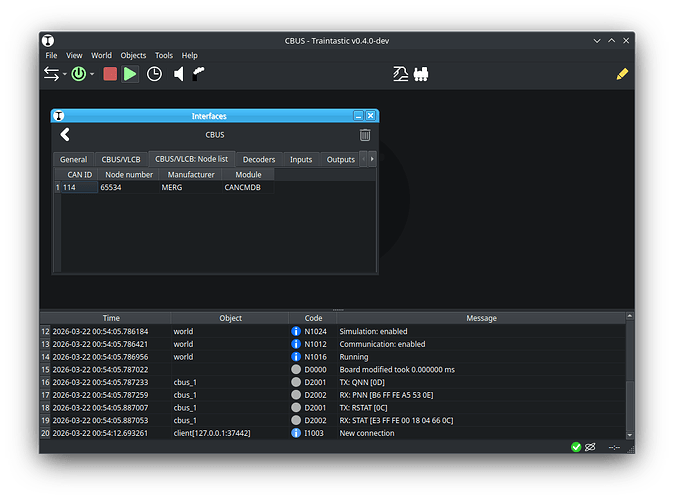

At power on these messages are send and receive on CBUS:
2026-03-15 21:13:25.046790 world N1012: Communication: enabled
2026-03-15 21:13:25.047690 cbus_1 D2001: TX: RSTAT [0C]
2026-03-15 21:13:25.047742 cbus_1 D2001: TX: QNN [0D]
2026-03-15 21:13:25.055163 cbus_1 D2002: RX: STAT [E3 FF FE 00 1C 04 66 0C]
2026-03-15 21:13:25.055922 cbus_1 D2002: RX: PNN [B6 00 01 A5 20 5F]
2026-03-15 21:13:25.056698 cbus_1 D2002: RX: PNN [B6 FF FF A5 09 0A]
2026-03-15 21:13:25.057561 cbus_1 D2002: RX: PNN [B6 FF FE A5 53 0E]

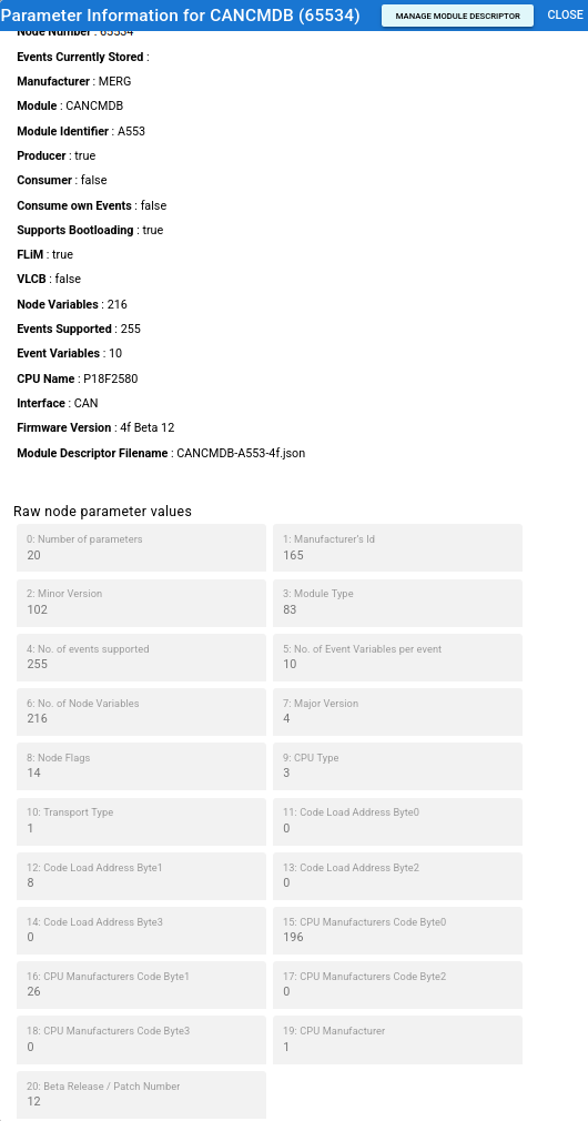

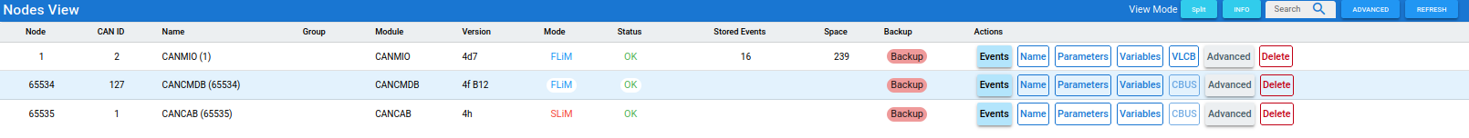

The PNN are the three CAN nodes: CANCMDB (central station, FFFE), CANCAB2 (FFFF) and CANVOUT (0001).

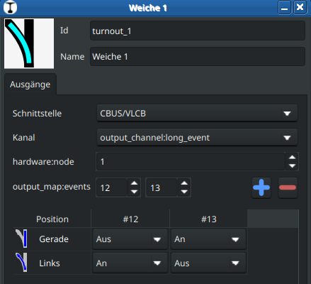

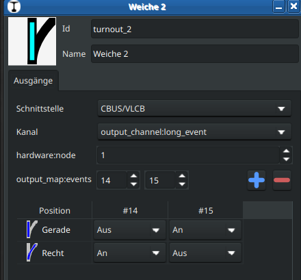

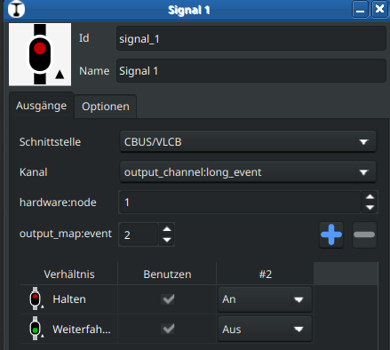

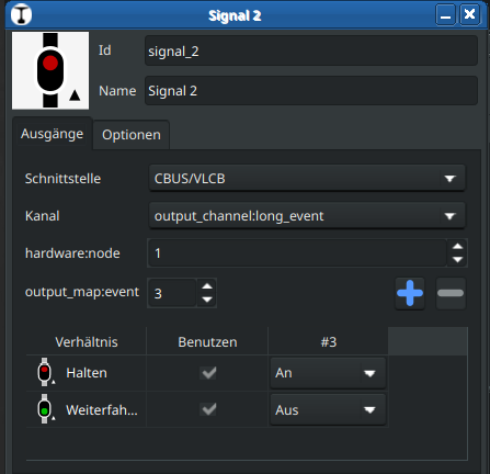

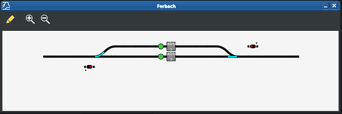

I configured this layout:
The left point and signal:
The right point and signal
And the two sensors:
There are some design problems, small input lines and so on. But this is at the moment not important! I will make a small screen video about this.
But the important things - it runs! :slight_smile:

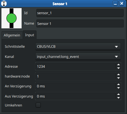

I can switch the points and signals, the LEDs at the output of the CANVOUT/CANMIO boards are switch correctly. That seems all right, at the moment I see here no problem.

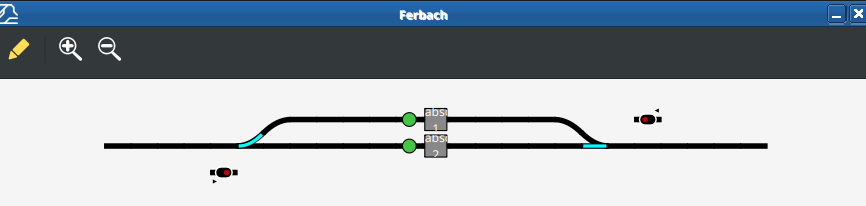

The inputs are recognized well. The sensors change the color to green. But they don’t goes off, if the sensor is free again. For the test I set the corresponding input port to Low (GND).
I use the setting occupied sensor for this test.
The input events looks like that:
2026-03-15 21:17:52.876271 cbus_1 D2002: RX: ACON node=1 event=1234 [90 00 01 04 D2]
2026-03-15 21:17:52.917297 cbus_1 D2002: RX: ACOF node=1 event=1234 [91 00 01 04 D2]
Port low → ACON, Port high → ACOF - this is correct. But the sensors remain green:
Should they not signal the state of the input? Or have them someother logic?
With the setting for the reed contact nothing happens. Also not with reverse mode.
I haven’t test the short events until yet.

Yes, all the kits are complete with all parts which are needed. Also includes all the kits a printed documentation “how to build” and the schematic of the board. A manual is not included but available as PDF.

Thanks for the STAT and PNN responses, I’ll see what I can do with them :slight_smile:
Found the sensor issue, I copied/modified the ACOF code to ACON but forgot to change false to true, see fe6a2197 :woozy_face:

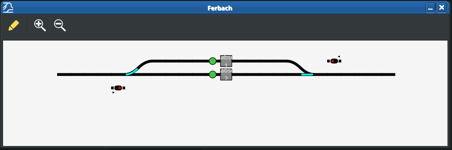

the sensors are now ok. I see no error with the 8 Inputs and 8 Outputs now. Great! What do you think about a list of events of the node, in the setup procedure of the board? I.e. I click a signal/point/sensor, set the node and there is a button to read all events from node, than a click on the event in the list to choose it for the signal/point/sensor? Not yet, but for the future :wink:

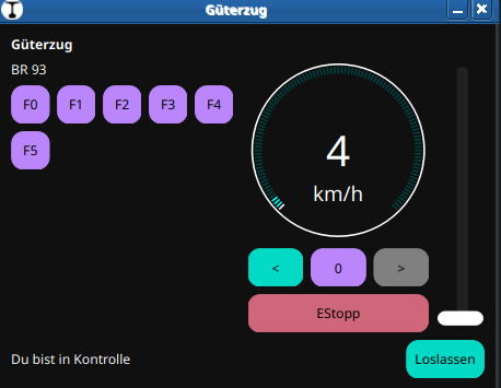

Traintastic sends also a DKEEP:
2026-03-16 22:58:19.894408 cbus_1 D2001: TX: DSPD session=1 speed=58 direction=fwd [47 01 BA]
2026-03-16 22:58:20.094540 cbus_1 D2001: TX: DSPD session=1 speed=59 direction=fwd [47 01 BB]
2026-03-16 22:58:24.094631 cbus_1 D2001: TX: DKEEP session=1 [23 01]
2026-03-16 22:58:28.094702 cbus_1 D2001: TX: DKEEP session=1 [23 01]
2026-03-16 22:58:32.094788 cbus_1 D2001: TX: DKEEP session=1 [23 01]
2026-03-16 22:58:32.457973 cbus_1 D2001: TX: DSPD session=1 speed=58 direction=fwd [47 01 BA]
2026-03-16 22:58:32.958406 cbus_1 D2001: TX: DSPD session=1 speed=57 direction=fwd
Also after stop the loco but every second:
2026-03-16 22:58:56.774789 cbus_1 D2001: TX: DSPD session=1 speed=2 direction=fwd [47 01 82]
2026-03-16 22:58:57.275227 cbus_1 D2001: TX: DSPD session=1 speed=0 direction=fwd [47 01 80]
2026-03-16 22:59:01.275247 cbus_1 D2001: TX: DKEEP session=1 [23 01]
2026-03-16 22:59:05.275292 cbus_1 D2001: TX: DKEEP session=1 [23 01]
2026-03-16 22:59:09.275379 cbus_1 D2001: TX: DKEEP session=1 [23 01]
2026-03-16 22:59:13.275463 cbus_1 D2001: TX: DKEEP session=1 [23 01]
After the loco is released in Traintastic, CANCAB2 still says that the loco is in use, when I choose it.
2026-03-16 23:03:53.400197 client_throttle_1 I3002: Throttle client_throttle_1 released train Güterzug
2026-03-16 23:03:53.400304 cbus_1 D2001: TX: GLOC short_address=3 mode=steal [61 00 03 01]
2026-03-16 23:03:53.403120 cbus_1 D2002: RX: ERR error=SessionCancelled session=1 [63 01 00 08]
2026-03-16 23:03:53.404422 cbus_1 D2002: RX: PLOC session=1 short_address=3 speed=13 direction=rev f0=false f1=false f2=false f3=false f4=false f5=false f6=false f7=false f8=false f9=false f10=false f11=false f12=false [E1 01 00 03 0D 00 00 00]
2026-03-16 23:03:53.404445 cbus_1 D2001: TX: STMOD session=1 speed_mode=128 service_mode=false sound_control_mode=false [44 01 00]
2026-03-16 23:03:53.404453 cbus_1 D2001: TX: DSPD session=1 speed=1 direction=rev [47 01 01]
2026-03-16 23:03:57.404525 cbus_1 D2001: TX: DKEEP session=1 [23 01]
2026-03-16 23:04:01.272317 cbus_1 D2002: RX: RLOC short_address=3 [40 00 03]
2026-03-16 23:04:01.273358 cbus_1 D2002: RX: ERR error=LocoAddressTaken short_address=3 [63 00 03 02]
2026-03-16 23:04:01.404586 cbus_1 D2001: TX: DKEEP session=1 [23 01]
This happens also, if I stop the Traintastic server. I have to power of CANCMDB to release the loco for use it again with CANCAB2.
Then basic input/output support is :white_check_mark:

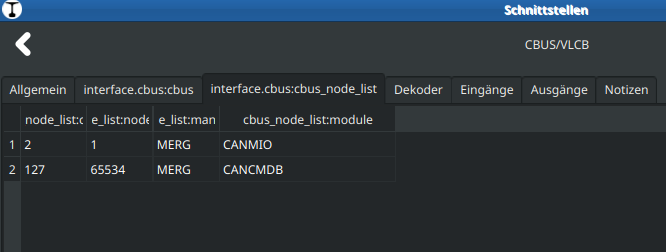

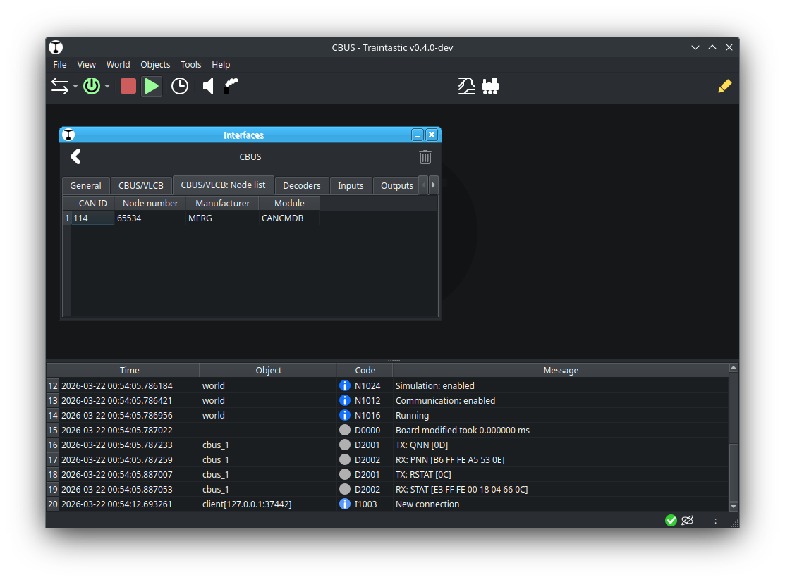

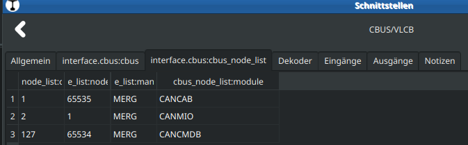

I like it, that will make life easier for future users :slight_smile:

CBUS/VLCB is the first hardware system that has a proper throttle acquire/release, Traintastic’s HAL isn’t currently aware of that, so I need to make some adjustments there. The CANCAB also has a Steal option, that should make it possible to take control even if Traintastic doesn’t release it properly.
Traintastic doesn’t allow to change direction if the train is moving, I can add a world setting for that to make it configurable. (The default value is debatable then :stuck_out_tongue:)

  • Basic list of discovered nodes. (nice to have)

Do you have a classic DCC turnout decoder? I’ve already added DCCext support and I’m adding support for standard DCC accessory but it needs testing :slight_smile:
I read in the CBUS/VLCB specs that there are also short/long on/off events with 1, 2 or 3 additional data bytes. Do you know what they are used for?
Do servo’s work using the same short/long event stuff?, I guess so, but just to be sure :slight_smile:
Nope, I have no DCC decoder for that. I never prefered to switch accessories with DCC, it’s not a good protocol to do that. DCC has no confirmation.
Do you mean ACON1, ACOF1 or ACON2 and so on? I have no idea which node uses that. However, the servo controllers have some parameters for angle, position and runtime. Also I found some article at MERG forum about analog values, i.e. positions. So I think a ACON2 could be used for switch on and drive until value reached databyte 2 or 3.

Small update, I added a node list:
This in simulaton mode, there only is a CANCMDB in it for now. This is just the info provided by the PNN response to the QNN. Need to read some more through the specs to see if there is more useful information to query.
today I have not done much, it was a lazy sunday. I update my repository, add the branch documentation and add some stylesheets from doxygen-awesome-css. It’s mainly for me to learn more about Traintastic :wink: I haven’t do a pull request, but if you want to have a look to the doxygen files traintastic/docs/doxygen/server/html at documentation · DL7BJ/traintastic · GitHub I like this design :slight_smile:
If you know all nodes, you could query all events from a node. I think this should be <NERD>There are also some instructions to read parameters and variables from a node.
The CANCAB2 is missing:
2026-03-22 21:15:54.728603 cbus_1 D2001: TX: QNN [0D]
2026-03-22 21:15:54.732056 cbus_1 D2002: RX: PNN node=65535 manufacturer_id=165 module_id=9 flags=0x0A [B6 FF FF A5 09 0A]
2026-03-22 21:15:54.732069 cbus_1 D2001: TX: RQNPN node=65535 param=7 [73 FF FF 07]
2026-03-22 21:15:54.732084 cbus_1 D2001: TX: RQNPN node=65535 param=2 [73 FF FF 02]
2026-03-22 21:15:54.732324 cbus_1 D2002: RX: ACK [00]
2026-03-22 21:15:54.733642 cbus_1 D2002: RX: PNN node=65534 manufacturer_id=165 module_id=83 flags=0x0E [B6 FF FE A5 53 0E]
2026-03-22 21:15:54.733658 cbus_1 D2001: TX: RQNPN node=65534 param=7 [73 FF FE 07]
2026-03-22 21:15:54.733668 cbus_1 D2001: TX: RQNPN node=65534 param=2 [73 FF FE 02]
2026-03-22 21:15:54.733891 cbus_1 D2002: RX: ACK [00]
2026-03-22 21:15:54.736640 cbus_1 D2002: RX: PNN node=1 manufacturer_id=165 module_id=32 flags=0x5F [B6 00 01 A5 20 5F]
But I think, it’s not so important to list here the throttles, however the CANCAB2 is seeing by the server, module_id 9.

My CANCMDB kit has the 4f version. I tried to read the parameters with MMC:
messageRouter: GRID_CONNECT_SEND RQNPN (73) Node 65534 Node parameter Index 1
messageRouter: GRID_CONNECT_RECEIVE PARAN (9B) Node 65534 Parameter Index 1 Parameter Value 165

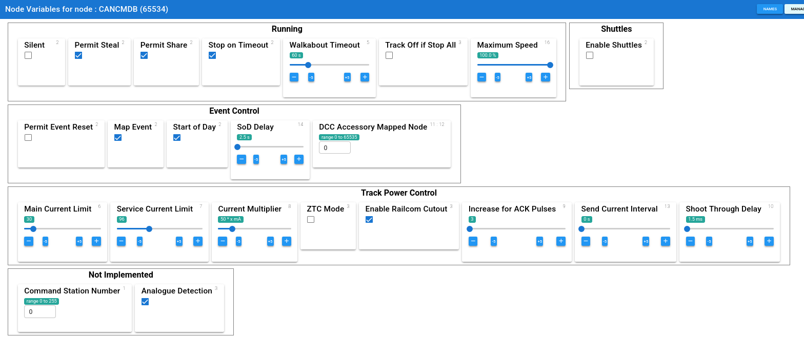

The CANCMDB has also some variables:
messageRouter: GRID_CONNECT_SEND NVRD (71) Node 65534 Node Variable Index 48
messageRouter: GRID_CONNECT_RECEIVE NVANS (97) Node 65534 Node Variable Index 48 Node Variable Value 0
And as I see with MMC, the CANCAB2 uses the SlimMode, perhaps that could be a problem.
MMC can’t read parameters or variables of CANCAB2. I will check, if the CANCAB has parameters, but it’s 100% assembler code.

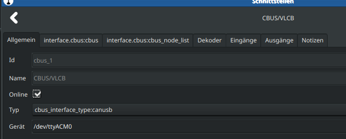

As I started the server the connection to /dev/ttyACM0 can’t be established. The hardware interface was offline, curios, I save always the world:
But after set it and restart server and client also the CANCAB2 is there.

This looks okay for me, it’s only a time of 3-4ms. The value is correct, look at my screenshot from MMC.
Hope that helps :slight_smile:
