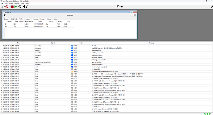

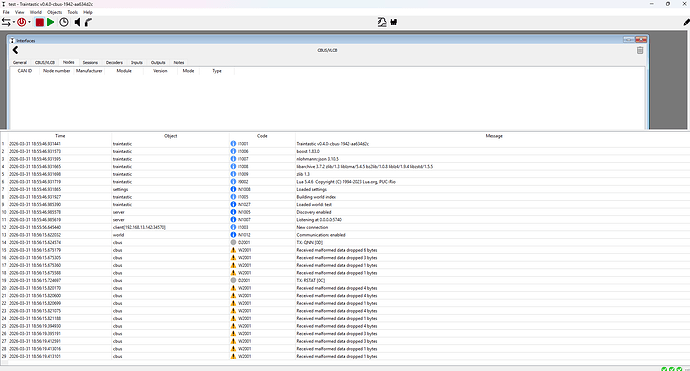

Canusb definitely does not like to come back online for me after mucking with world and connections → E2002 Serial read failed ( bad address )
Is there a remote chance the serial connection is not torn down completely hence leading to strange behaviours?
After stop/start of the Traintastic server → all connections are working.
Perhaps a stale serial connection left behind??

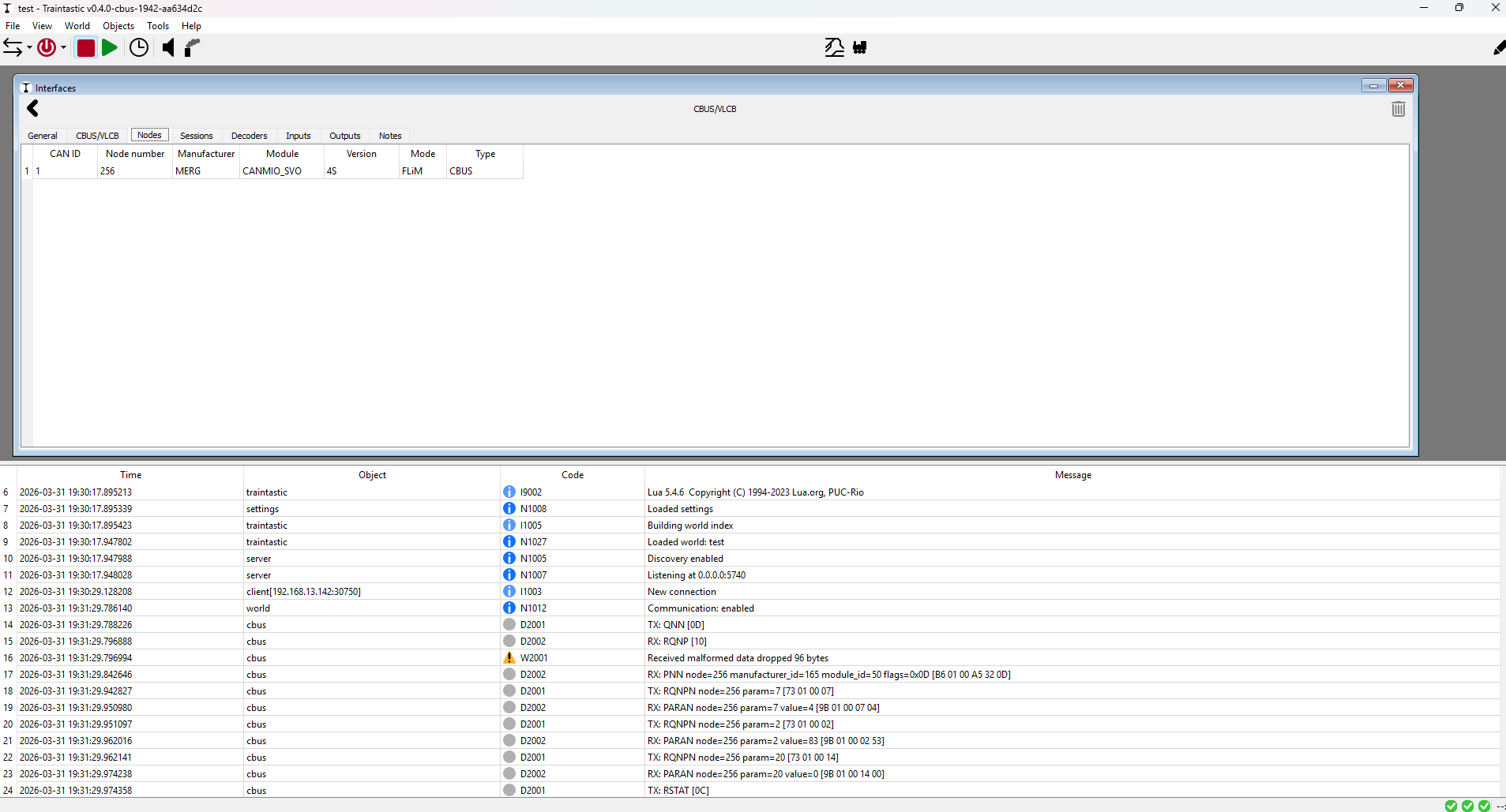

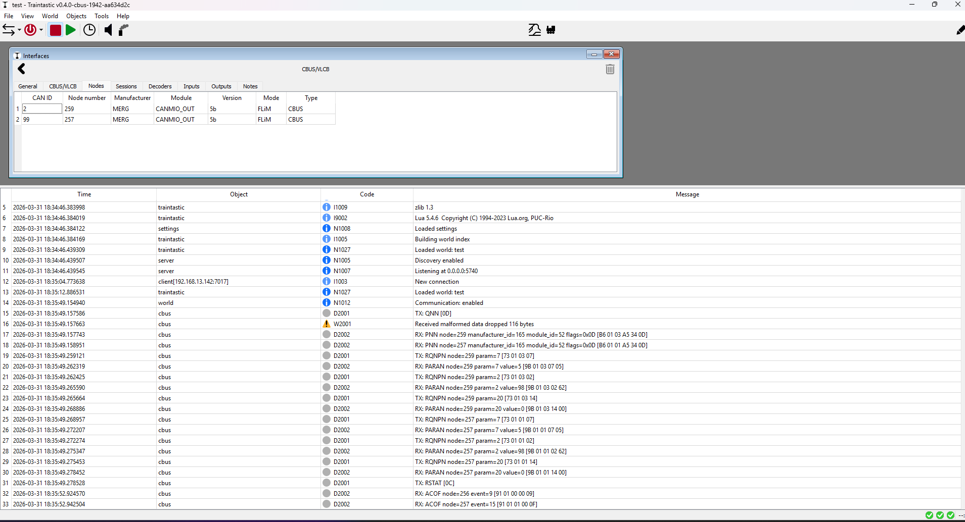

Scan looks better, but my most-populated node ( canmio-server node # 256 is still absent. Better!
Switching between Ethernet and USB mode? I think something in the backgound must get stuck because the CBUS interface will not come back online.
Via USB:
Via etnernet ( JMRI CBUS hub: )
After removal of usb serial +addition of network variant + stop/start of server:
Just in case i have done some cleanup and made sure there is only one world in the world path, and connection is via Network; as well as restart of server side. First minor succes: Cbus via ethernet is saying hello:
but only from 1 node:

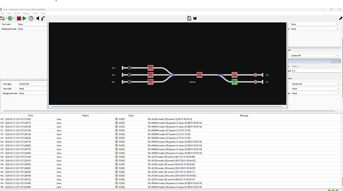

Observed issues with taking the world offline/online: Sometimes CBUS/USB will get in a bind → stop/start server
On detection:
Will do more investigtions, but it looks that the block occupancy on startup is doing something strange.

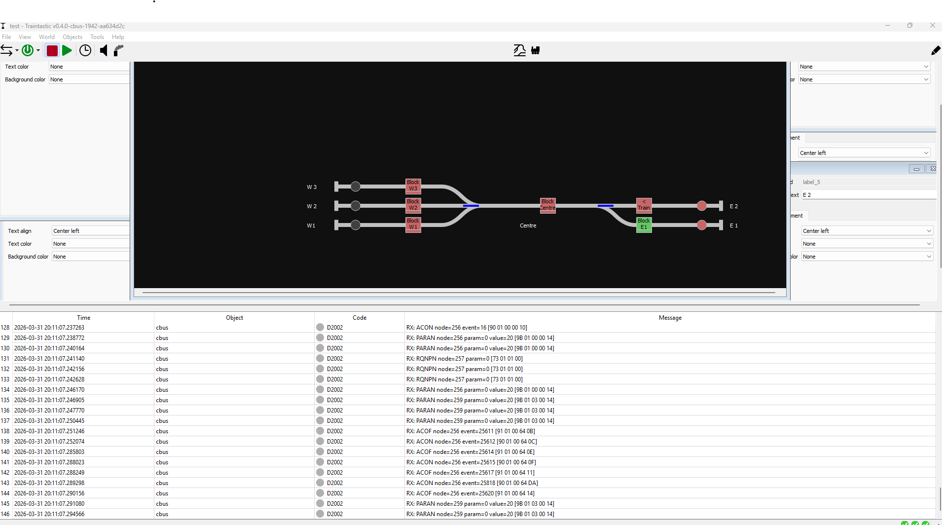

Fresh start ( merg cbus string powered down, restart traintastic )
Traintastic thinks this is the current state:
While reality says:
Or in words: the only 2 block occupied are:
  • Centre
  • East 2 [ due to my programming track / rolling road clipped on via East 2 ]

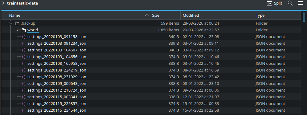

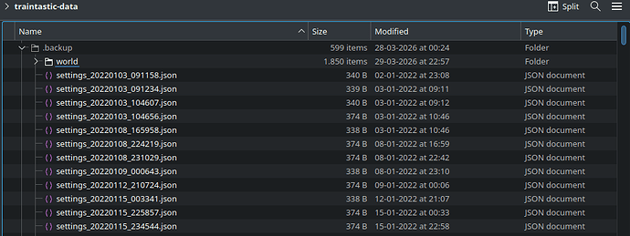

Traintastic already creates a backup on each save (it moves the old save to a backup folder and then saves the world to a new file), what is missing is a proper UI to actually load a backup… If you go to traintastic’s data folder you’ll see a .backup folder that contains world and setting backups:
Usually if a port is still open, the open command will fail not the write. Can you enable the server file log option, and then do it again and post the log here, based on a single error message it is hard for me to analyze the issue, I need more insight on the performed actions.

On detection:
Based on the log I see all kind of events being received, I see multiple ON and OFF event. How are the events mapped to the blocks?
Does this also happen if you connect directly with CANUSB and no JMRI active?

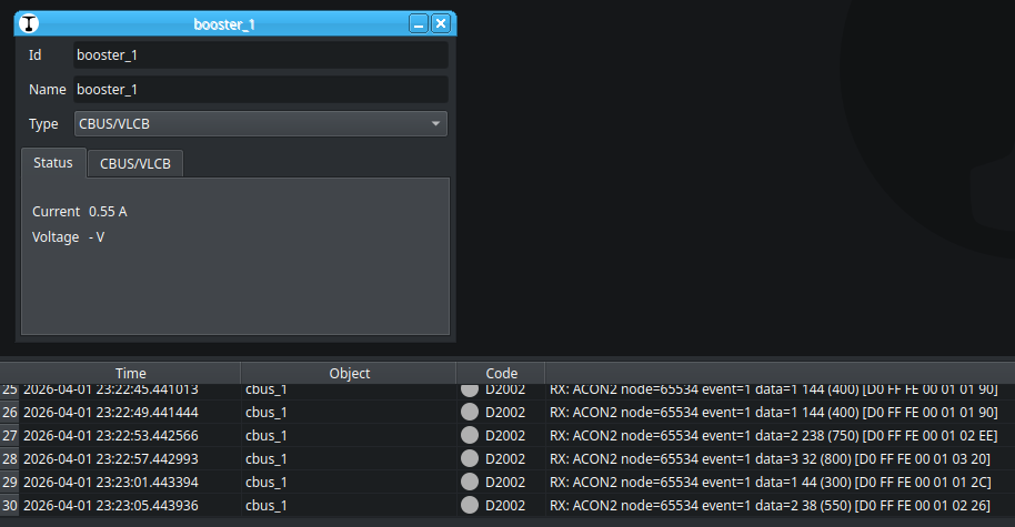

The data 1 244 are the average of the voltage read by A/D conversion of the controller multiplied by 50 as 16 Bit value, found it in the CANCMDB code. For the main track it use a 0.1R current sense resistor at Sense A (pin 1) of the L298N; I never used this driver and read just the datasheet. The max current for a half L298 is 2A. So the max voltage for A/D conversion can be 200mV. The two bytes are 1 x 256 + 244 = 500 → 500 / 50 = 10. The converted A/D value must be ~10 for 550mA. The A/D converter is a 10Bit, the reference voltage 5V → 10 / 1023 * 5 = 49mV. I = U/R → 49mV/0.1R = 0.49A
Thorough investigation, I crossed checked it with the JMRI source, they read it as mA as well, so now we know for sure :slight_smile: The ACON2 NN:65534 EN:2 is the voltage in 100mV steps according to the JMRI source, it it possible to enable that using MMC?
I’ll look into building smart booster support for CBUS/VLCB, Traintastic currenlt only supports LocoNet smart boosters, so its a nice HAL test :slight_smile:

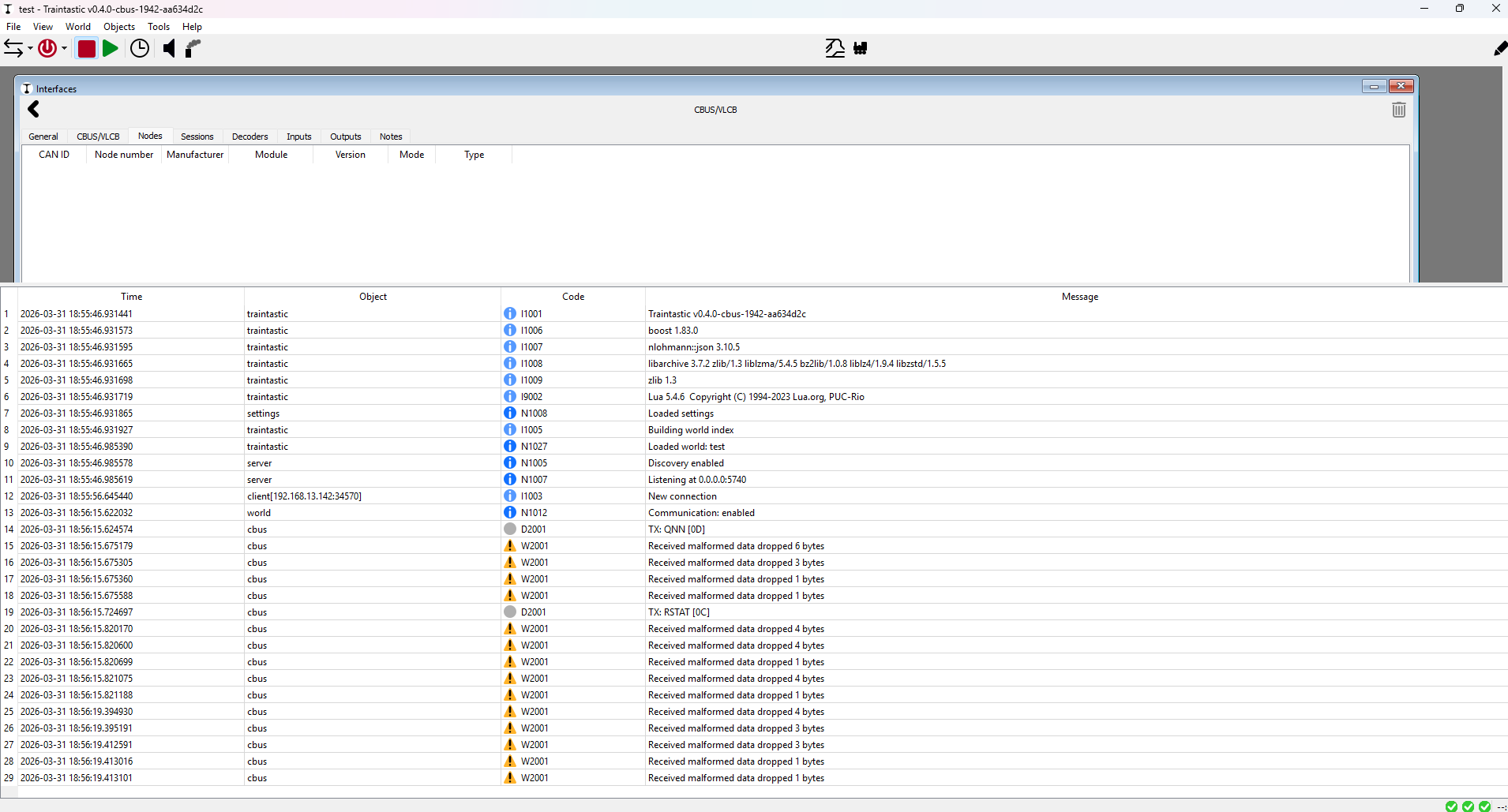

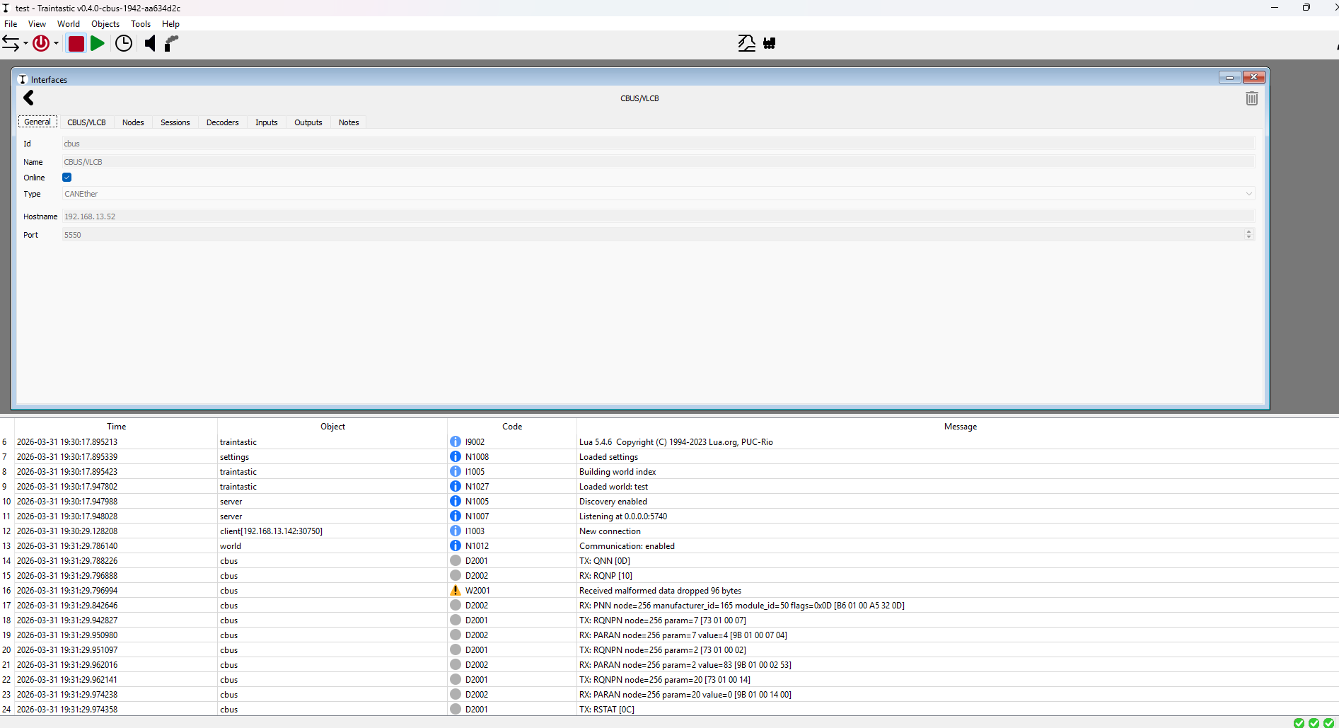

I made some short tests. But that’s not my way of testing things. We have Traintastic, JMRI with the hub and CANUSB — that’s too many potential sources of error for me. First, Traintastic should be tested with the CANETHER, not with software that might contain bugs. That’s too much uncertainty for me.
I got this with Traintastic:
2026-03-31 23:31:48.703084 world N1012: Communication: enabled
2026-03-31 23:31:48.703478 cbus_2 E1007: Socket read failed (Bad address)
2026-03-31 23:31:50.795224 world N1016: Running
2026-03-31 23:31:56.815078 cbus_2 E1007: Socket read failed (Bad address)
2026-03-31 23:32:01.404809 cbus_2 E1007: Socket read failed (Bad address)
2026-03-31 23:32:02.720720 cbus_2 E1007: Socket read failed (Bad address)
2026-03-31 23:32:03.711346 cbus_2 E1007: Socket read failed (Bad address)
And this with JMRI if I start Traintastic:
MRI  < <  CBUS |  QNN  Query node numbers
JMRI  > >  CBUS |  QNN  Query node numbers
JMRI  < <  CBUS |  PNN NN:65535  Manuf ID: 165 Mod ID: 9 Flags: 10 Query Node Response
JMRI  < <  CBUS |  PNN NN:1  Manuf ID: 165 Mod ID: 32 Flags: 95 Query Node Response
JMRI  < <  CBUS |  PNN NN:65534  Manuf ID: 165 Mod ID: 83 Flags: 14 Query Node Response
That shows the answers of the three nodes I have. But in Traintastic I see nothing of this answers, only this:
026-03-31 23:48:01.240731 client[127.0.0.1:33602] I1003: New connection
2026-03-31 23:48:05.274293 world N1012: Communication: enabled
2026-03-31 23:48:05.274839 cbus_2 E1007: Socket read failed (Bad address)
And it cannot be ruled out that this is a problem with the JMRI Hub. With telnet 5550 I could connect to the JMRI Hub, but that says nothing. I don’t like primary tests with intermediate solutions like JMRI here; you never know where to look. I think we need to focus on the essentials here: the CANUSB and CANETHER hardware interfaces. Since I’m not planning on a network connection, I don’t have CANETHER.

Moin Tom & Menno,
Implemented reading the CANCMD current reading :slight_smile:
Tested it using virtual SocketCAN interface (on Linux), a Python script generated the ACON2 events: utils/cbus/cbus_cancmdb_current_sim.py
@reinder Benefit of having automatons? TEST FRAMEWORK! :rofl:
good move!
Automated tests go a long way but it will take some real users to find the weak spots outside the (automated) happy path…
If you ever need a good reason to cater for sensor support in points or general protection…
Layout fire due to short-circuits
This I see with telnet localhost 5550:
tom@amarok:~$ telnet localhost 5550
Trying ::1...
Connected to localhost.
Escape character is '^]'.
:SBFE0ND0FFFE00010000;:SBFE0ND0FFFE00010000;:SBFE0ND0FFFE00010000;:SBFE0ND0FFFE00010000;:SBFE0ND0FFFE00010000;:SBFE0ND0FFFE00010000;:SBFE0ND0FFFE00010000;:SBFE0ND0FFFE00010000;:SBFE0ND0FFFE00010000;:SBFE0ND0FFFE00010000;:SBFE0ND0FFFE00010000;:SBFE0ND0FFFE00010000;:SBFE0ND0FFFE00010000;:SBFE0ND0FFFE00010000;:SBFE0ND0FFFE00010000;:SBFE0ND0FFFE00010000;:SBFE0ND0FFFE00010000;:SBFE0ND0FFFE00010000;:SBFE0ND0FFFE00010000;:SBFE0ND0FFFE00010000;:SBFE0ND0FFFE00010000;:SBFE0ND0FFFE00010000;:SBFE0ND0FFFE00010000;:SBFE0ND0FFFE00010000;:SBFE0ND0FFFE00010000;:SBFE0ND0FFFE00010000;:SBFE0ND0FFFE00010000;:SBFE0ND0FFFE00010000;:SBFE0ND0FFFE00010000;:SBFE0ND0FFFE00010000;:SBFE0ND0FFFE00010000;:SBFE0ND0FFFE00010000;:SBFE0ND0FFFE00010000;:SBFE0ND0FFFE00010000;:SBFE0ND0FFFE00010000;:SBFE0ND0FFFE00010000;:SBFE0ND0FFFE00010000;:SBFE0ND0FFFE00010000;:SBFE0ND0FFFE00010000;:SBFE0ND0FFFE00010000;:SBFE0ND0FFFE00010000;:SBFE0ND0FFFE00010000;:SBFE0ND0FFFE00010000;:SBFE0ND0FFFE00010000;:SBFE0ND0FFFE00010000;:SBFE0ND0FFFE00010000;:SBFE0ND0FFFE00010000;:SBFE0ND0FFFE00010000;:SBFE0ND0FFFE00010000;:SBFE0ND0FFFE00010000;:SBFE0ND0FFFE00010000;:SBFE0ND0FFFE00010000;:SBFE0ND0FFFE00010000;:SBFE0ND0FFFE00010000;:SBFE0ND0FFFE00010000;:SBFE0R;:SBFE0N;:SB020N400003;:SBFE0NE101000380000000;:SB020N440100;:SB020N470180;:SBFE0ND0FFFE00010000;:SB020N2301;:SB020N470182;:SBFE0ND0FFFE00010032;:SB020N470183;:SB020N470184;:SB020N470185;:SB020N470186;:SB020N470187;:SB020N470188;:SB020N470189;:SBFE0ND0FFFE00010064;:SB020N2301;:SB020N47018A;:SBFE0ND0FFFE00010064;:SB020N47018B;:SB020N47018C;:SB020N47018D;:SB020N470190;:SB020N470192;:SB020N470193;:SBFE0ND0FFFE00010064;:SB020N2301;:SBFE0ND0FFFE00010032;:SB020N470180;:SB020N2301;:SBFE0ND0FFFE00010096;:SBFE0ND0FFFE00010000;:SB020N2301;:SBFE0ND0FFFE00010000;:SBFE0ND0FFFE00010000;:SB020N2301;:SBFE0ND0FFFE00010000;:SB020N2301;:SBFE0ND0FFFE00010000;
After the ‘N’ is a D0 (ACON2) before the node address and after the node address the 8 data bytes.
