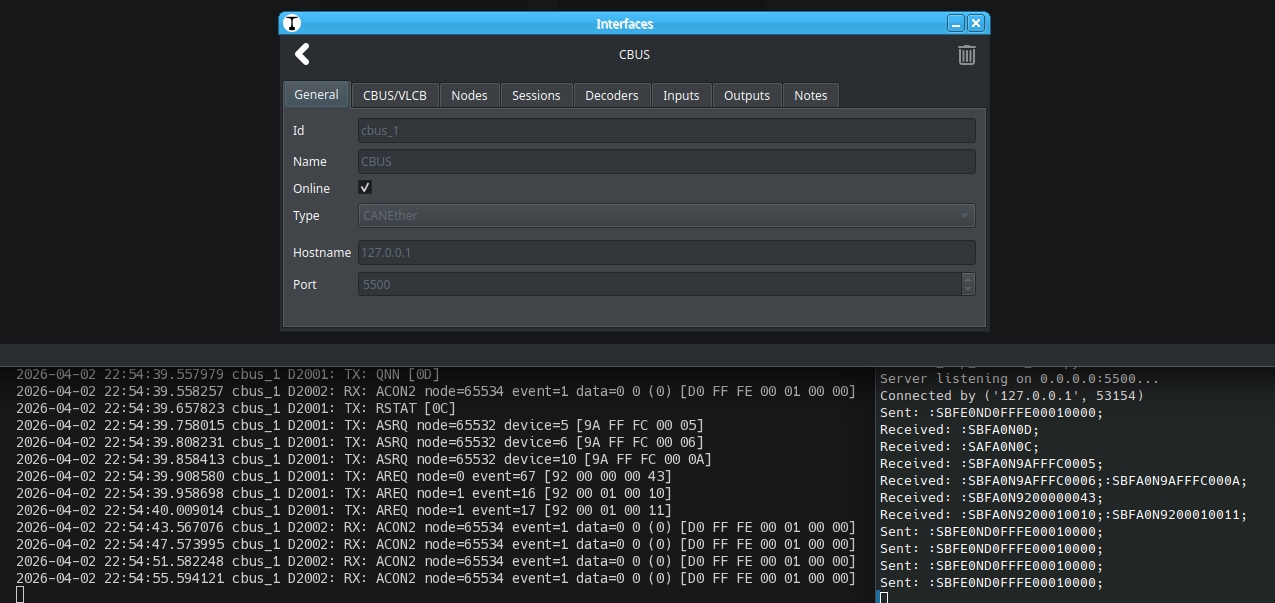

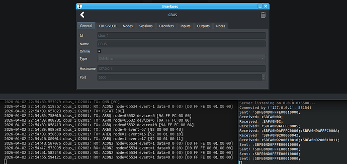

It works using a Python dummy server:
Yes, I know, but Github means I were in sync. Must logoff and logon.
I start the server and than the client:
Enable the communication:

2026-04-02 23:03:24.499963 client[127.0.0.1:56480] I1003: New connection
2026-04-02 23:04:34.501802 world N1012: Communication: enabled

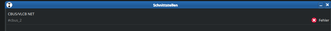

2026-04-02 23:04:34.502218 cbus_2 E1007: Socket read failed (Bad address)

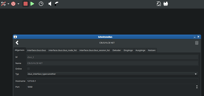

Click on green run arrow:
2026-04-02 23:05:39.482431 world N1016: Running

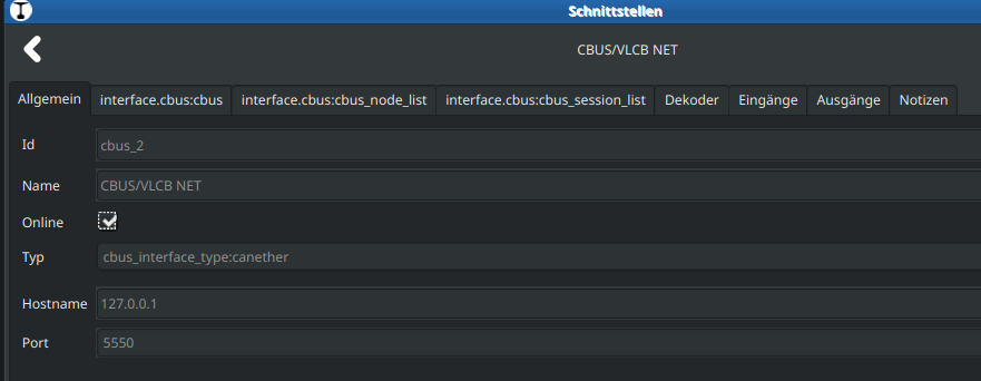

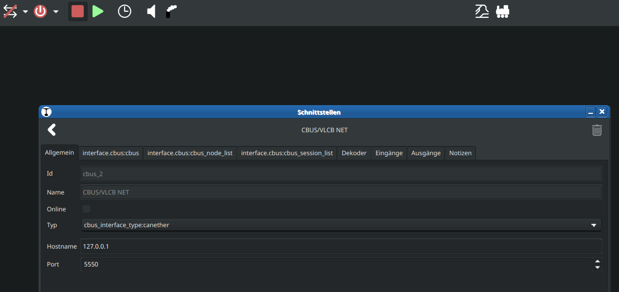

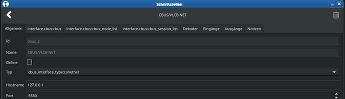

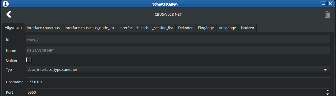

The checkmark for Online is not active:
I have to click the online checkmark several times until it stays.
2026-04-02 23:08:32.206152 cbus_2 E1007: Socket read failed (Bad address)
2026-04-02 23:08:33.094164 cbus_2 E1007: Socket read failed (Bad address)
2026-04-02 23:08:33.701826 cbus_2 E1007: Socket read failed (Bad address)
2026-04-02 23:08:34.146515 cbus_2 E1007: Socket read failed (Bad address)
2026-04-02 23:08:36.615410 cbus_2 E1007: Socket read failed (Bad address)
2026-04-02 23:08:36.986833 cbus_2 E1007: Socket read failed (Bad address)
2026-04-02 23:08:37.290270 cbus_2 E1007: Socket read failed (Bad address)
2026-04-02 23:08:37.754598 cbus_2 W2001: Received malformed data dropped 48 bytes

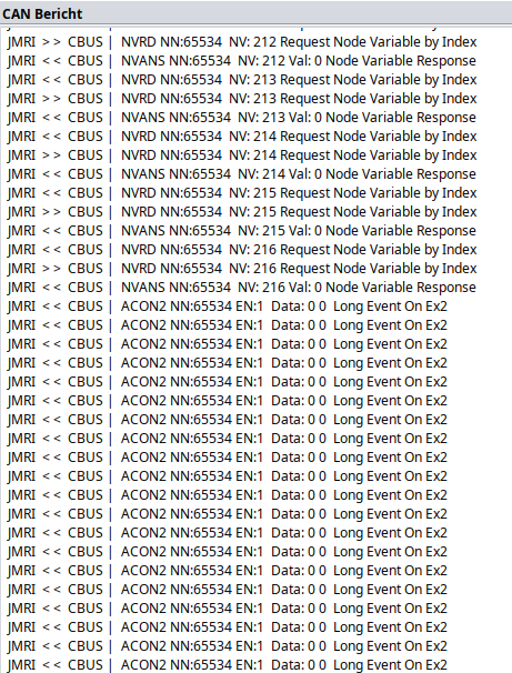

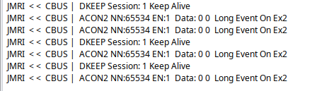

During this test the telnet connection and JMRI Hub are open and every 5s I see the current message of CANCMDB with telnet and JRMI.
Hope that helps!

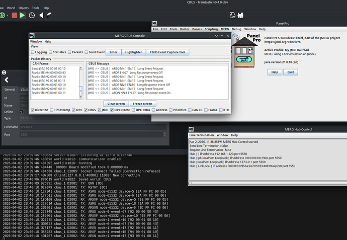

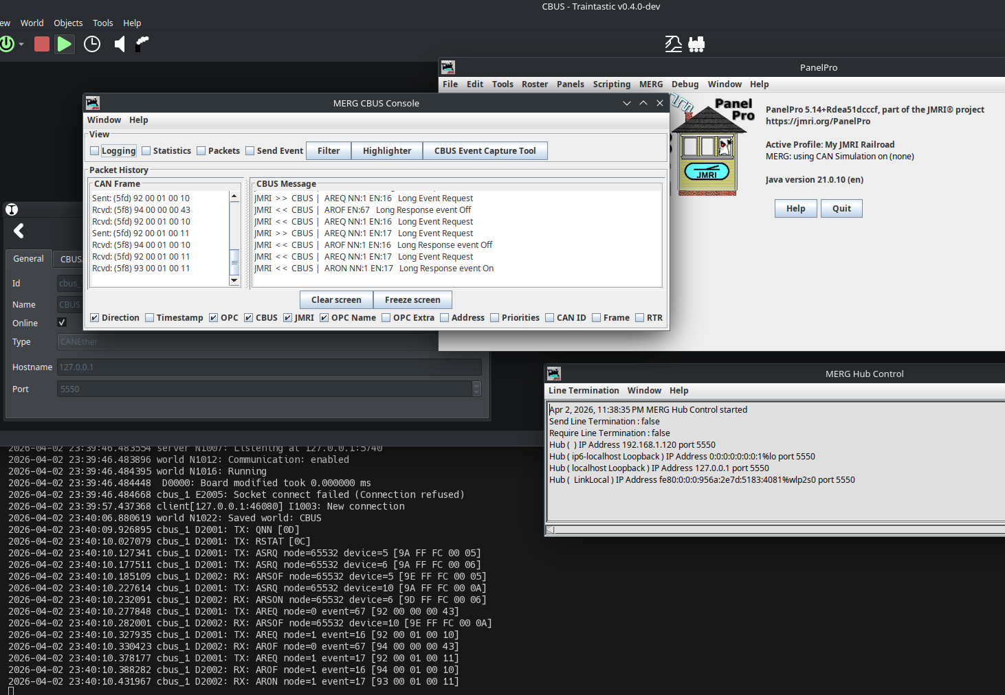

Just fired up JMRI using MREG+Simulation and enabled the Hub:
It works…
with the hardware not :frowning: I made a tcpdump, beginning with the start of Traintastic.
traintastic.pcap.txt (11.7 KB)

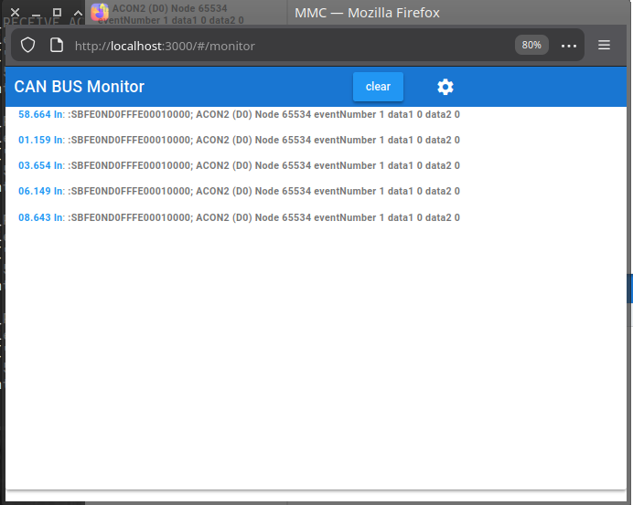

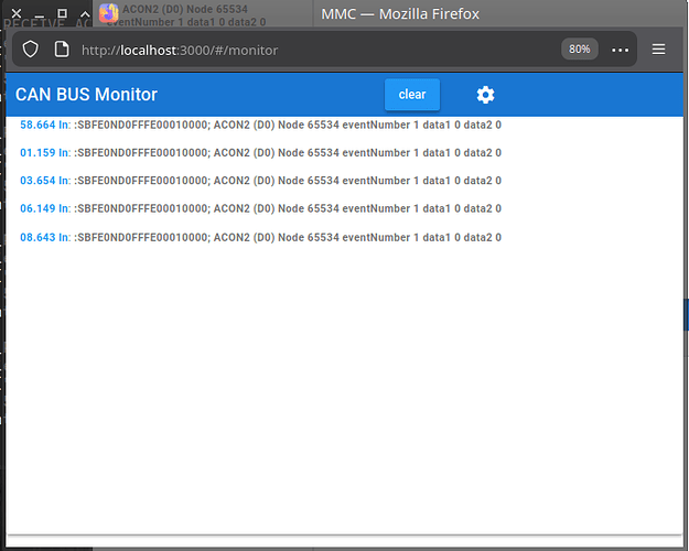

I just test MMC-Server with JMRI CBUS Hub. This runs without problems:
I wrote a small test prg to check, if some other errors exists:
tom@amarok:~/projects/linux/samples/boosttcp$ ./main
Connected to 127.0.0.1:5550
:SBFE0ND0FFFE00010000;:SBFE0ND0FFFE00010000;:SBFE0ND0FFFE00010000;
The code:

I’m getting desperate with GitHub! GitHub keeps claiming my fork is in sync, but it isn’t. As a result, I’ve been missing updates for four days, including this one, and this was the cause:
[cbus] fix: ASCIIIOHandler m_readBufferOffset wasn't initialized

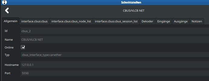

I found it myself with debugging and after that I view in your repo where I see that it is initialized. Why Github says, that my fork is in sync?
Now the problem with the Online checkmark is also gone.

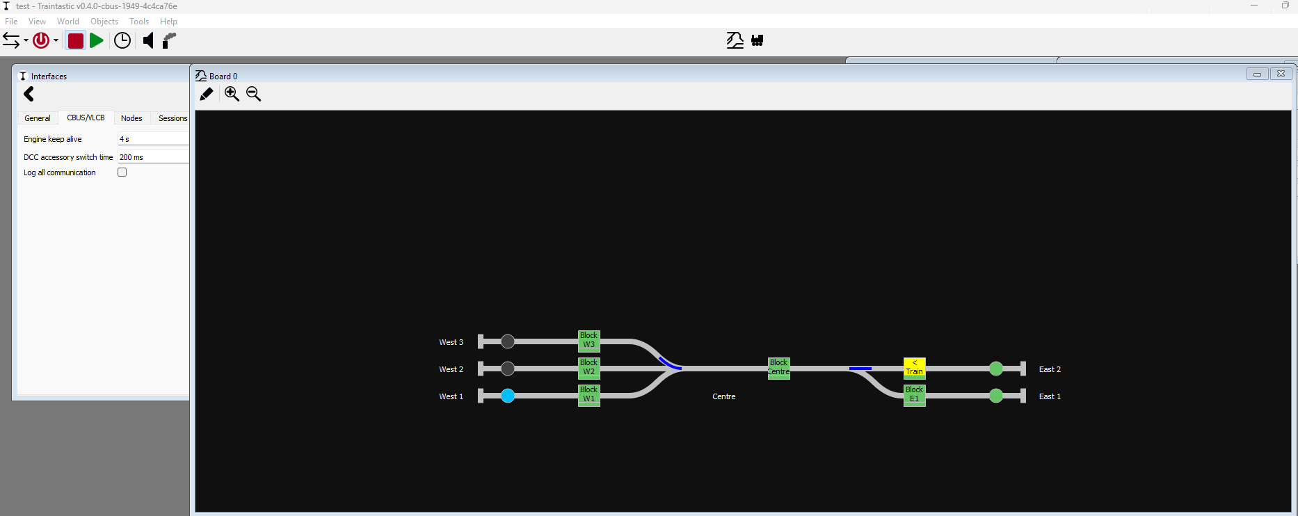

Lets give this new build a try ( 1949 ) on canEther via Jmri CBUS.
Will re-run via USB direct.
first:

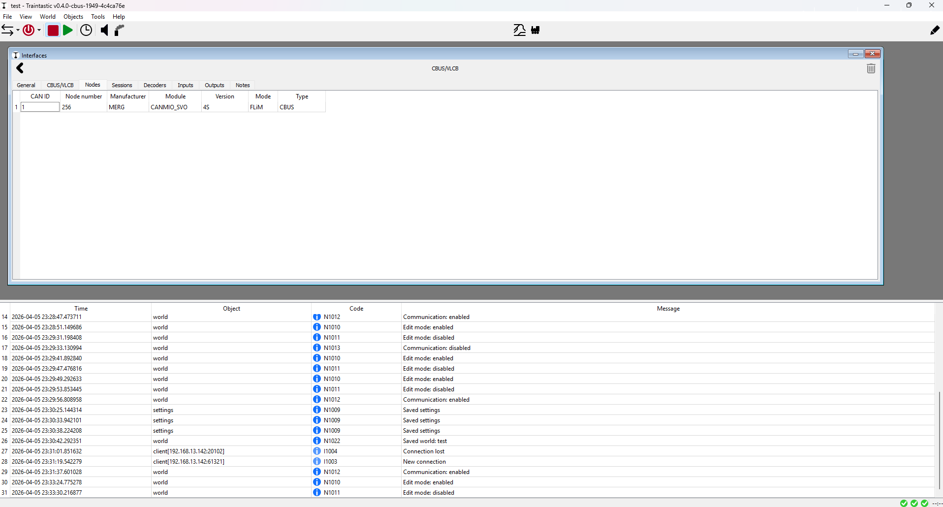

Do you recognize this error after update/install?
Download is performed unsandboxed as root as file '/root/traintastic-server_0.4.0~ubuntu~noble~cbus~1949~4c4ca76e_amd64.deb' couldn't be accessed by user '_apt'. - pkgAcquire::Run (13: Permission denied)
After install of packages: my own world files gone :cross_mark:
… i know how to get that back, been there :slight_smile:
It looks like i only see 1 board detected and no log entries of failures.
Love the absence of errors. However why are the other elements not reporting?
… strange

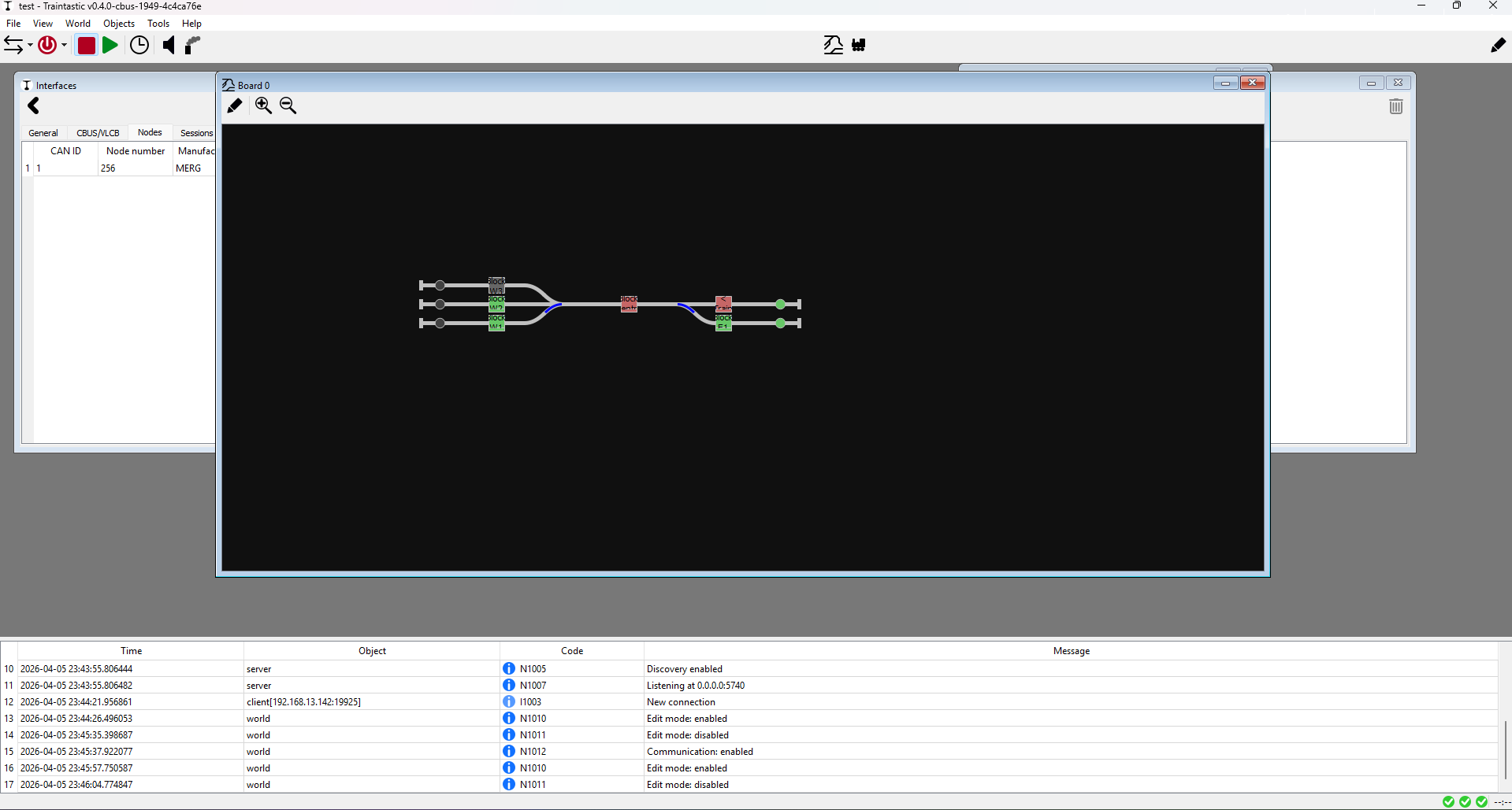

Food for thought:
If you have powered off in the GUI, should we present the world of sensors in dark → no info?
Reason: I just powered on and everything seems fine..
Except it is not → ghosts + some sensors seem to have lost reference to their CBUS nodes ( potentially due to switching from USB ↔ Ether while deleting the interface in previous versions … )
… that might be my wrongdoing but in this case slightly confusing?
Restored all the connections ( sensors on CBUS → sensors in world )
World powered off:
What makes even less sense to me:
World is powered on, track power is switched off at the command station
Expectation: no power to tracks → sensors should not be showing occupancy.
Block East 2 shows YELLOW with a train; except there is no longer a train defined :confused:

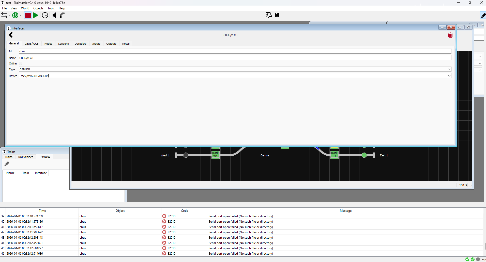

Bigger problem:
I changed my CANUSB from ethernet to /dev/ttyACM0. Ofourse it fails to come online. Fine; Save & reboot so nothing claims the port.
Surprise: Traintastic fails to start and it is the only thing that is claiming USB ports.
Nothing special in the logfiles:

2026-04-06;01:02:21.237298;settings;N1008;Loaded settings
2026-04-06;01:02:21.237375;traintastic;I1005;Building world index
=== Traintastic v0.4.0-cbus-1949-4c4ca76e
2026-04-06;01:02:21.485090;traintastic;I1001;Traintastic v0.4.0-cbus-1949-4c4ca76e
2026-04-06;01:02:21.485207;traintastic;I1006;boost 1.83.0
2026-04-06;01:02:21.485223;traintastic;I1007;nlohmann::json 3.10.5
2026-04-06;01:02:21.485282;traintastic;I1008;libarchive 3.7.2 zlib/1.3 liblzma/5.4.5 bz2lib/1.0.8 liblz4/1.9.4 libzstd/1.5.5
2026-04-06;01:02:21.485305;traintastic;I1009;zlib 1.3
2026-04-06;01:02:21.485318;traintastic;I9002;Lua 5.4.6  Copyright (C) 1994-2023 Lua.org, PUC-Rio
2026-04-06;01:02:21.485483;settings;N1008;Loaded settings
2026-04-06;01:02:21.485549;traintastic;I1005;Building world index
traintastic.txt (END)
and no service start:
 ✘ ⚡ root@dcc-master  /var/opt/traintastic/log  systemctl status traintastic-server.service accounts-daemon.servic
Unit accounts-daemon.servic.service could not be found.
× traintastic-server.service - Traintastic server daemon
     Loaded: loaded (/usr/lib/systemd/system/traintastic-server.service; enabled; preset: enabled)
     Active: failed (Result: signal) since Mon 2026-04-06 01:02:21 AEST; 1min 9s ago
   Duration: 61ms
    Process: 3144 ExecStart=/opt/traintastic/bin/traintastic-server -d -u traintastic -g traintastic -D /var/opt/traintastic -P (code=exited, status=0/SUCCESS)
   Main PID: 3146 (code=killed, signal=SEGV)
        CPU: 77ms
Apr 06 01:02:21 dcc-master.cook-rd.internal systemd[1]: traintastic-server.service: Scheduled restart job, restart counter is at 5.
Apr 06 01:02:21 dcc-master.cook-rd.internal systemd[1]: traintastic-server.service: Start request repeated too quickly.
Apr 06 01:02:21 dcc-master.cook-rd.internal systemd[1]: traintastic-server.service: Failed with result 'signal'.
Apr 06 01:02:21 dcc-master.cook-rd.internal systemd[1]: Failed to start traintastic-server.service - Traintastic server daemon.
IMHO: If you cut all track power, any DTC4 should not be able to detect any power differential useage → sensor should go to false
Moreover: i am installing a thing → generally apt install requires root right. Unless i am holding it fundamentally wrong? :slight_smile:
@reinder / @DL7BJ
Apologies if i am going to be the pain in your sides for attempting things that might break stuff → ultimately i hope it will make traintastic better :slight_smile:
Traintastic shows a block red/green based in the reported sensor values, this in independent of the track signal, there are systems that can detect a train even if there is no track power. Blocks are yellow if they are reserved by a train. A train must always in at least one block. Normally if a block goes from “red” to “green” the train has left the block (if it is the tail block), if a train is in a single block and it goes “green”, the block stays “yellow”, else the train would be vanished, you have to explicitly remove a train in that case. Else trains could disappear easily e.g. due to bad contact causing sensor triggering.
Can you enable communication debug logging? That will help to see what is missing.
If you delete an interface all linked sensors are lost, as the interface no longer exists.
After checking ports + screens no port 5550 up and no quick visible spots where to configure. I may be holding it wrong / be to early to ask :slight_smile:
Do you mean for the Hub feature? It is not yet available, still working on it, it might take a few days (depending on how much time I have), I’m working on a more generic solution that I can reuse for other CAN based protocols as well :slight_smile: (e.g. MarklinCAN and future OpenLCB/LCC)
