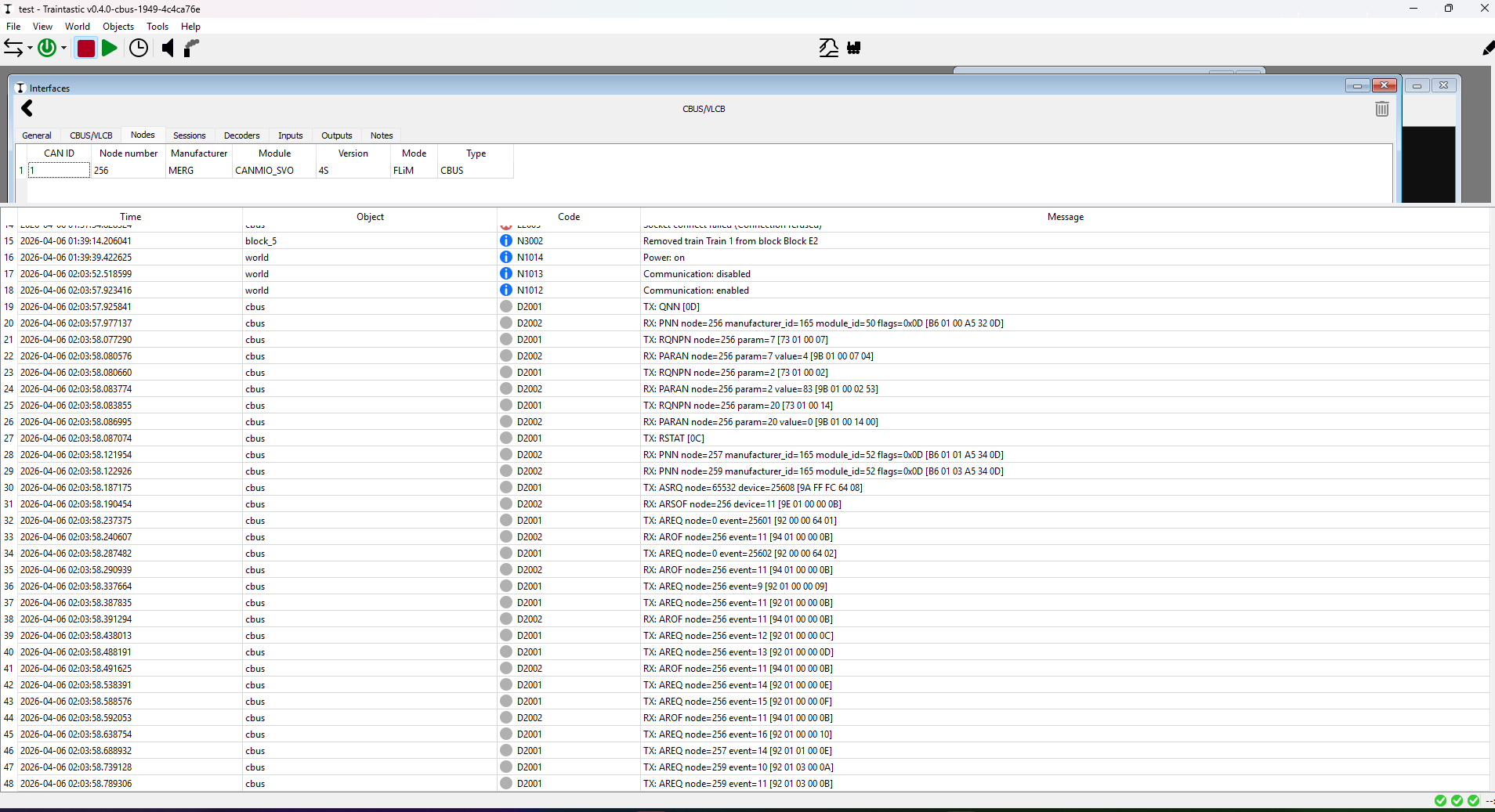

CanUSB via USB ( same with ethernet via JMRI hub )
Only 1 board found.
Log does mention AREQ 257/259 but not present in the node list
PS: off to bed with me, 0300 is early enough :slight_smile:
@MZwa the modules are responding a bit slowly, Traintastic’s timeout is 100ms, the modules respond just over 100ms, I’ll raise the timeout to 250ms. The 100ms was just a guess, it worked at @DL7BJ’s setup.

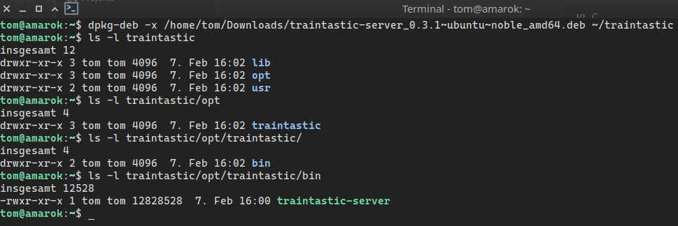

As far as I know it it not possible to install in $HOME using a deb file, therefor it is installed in /opt. Another distribution option for Traintastic for Linux would be using e.g. AppImage. Never build something like that, need to look into it.
It’s possible to unpack a deb or it do like this: sudo dpkg --root=$HOME/local -i paket.deb but the rights must changed for the user.
The package don’t contains the libs, I have no libboost-1.83 installed, so I can’t start the server. This could be a problem with different distributions and deb could also be a problem with Fedora, SuSE, Arch (it’s possible, but the user must have the knowledge). This is always a problem with the different packet managers and different linux distributions.
Therefore a AppImage is the solution. You put all neccessary files in a folder structure like bin, usr, lib and build with appimagetool one executable file; the AppImage. There are some tools; more like Innosetup for Windows.

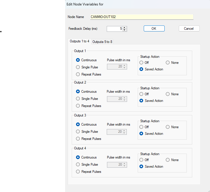

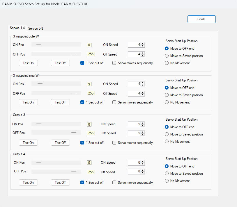

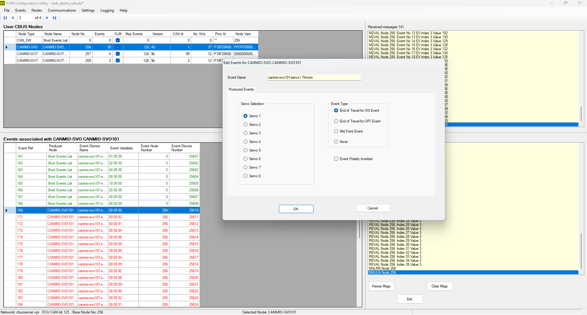

I can not remember this dialog [ my config has been around for a while and FliM config has gone through a couple of updates in the mean time ]
But this might as well be a more dummy-friendly way to set the start of day on a node:
It is part of the standard Config software with a few mouse-clicks
Yes i am a dinosaur, i have FliM and not the NodeJS config software :rofl:
Based on the above canmio-out / probably any of the canv series
will more than likely expose the same behavior.
canmio-out can be used as driver for leds relays etc.
canv4bip solenoid driver: appears to have the feature as well.
Any recent board out of the CANV series has a common software ancestry before setting up the “thing” that makes it special
4)How does it work in combination with the start of day event?
Hope the screenshots help a bit.
what it boils down to:
  1. set your “action” event [ servo | solenoid | tortoise motor | led | whatever ]
  2. setup events to emit on state change
  3. set powerup behaviour activate one action from 1)
  4. write config
  5. powercycle
upon power-cycle the servo will move to it’s desired position and will emit any changes set up that it encounters.

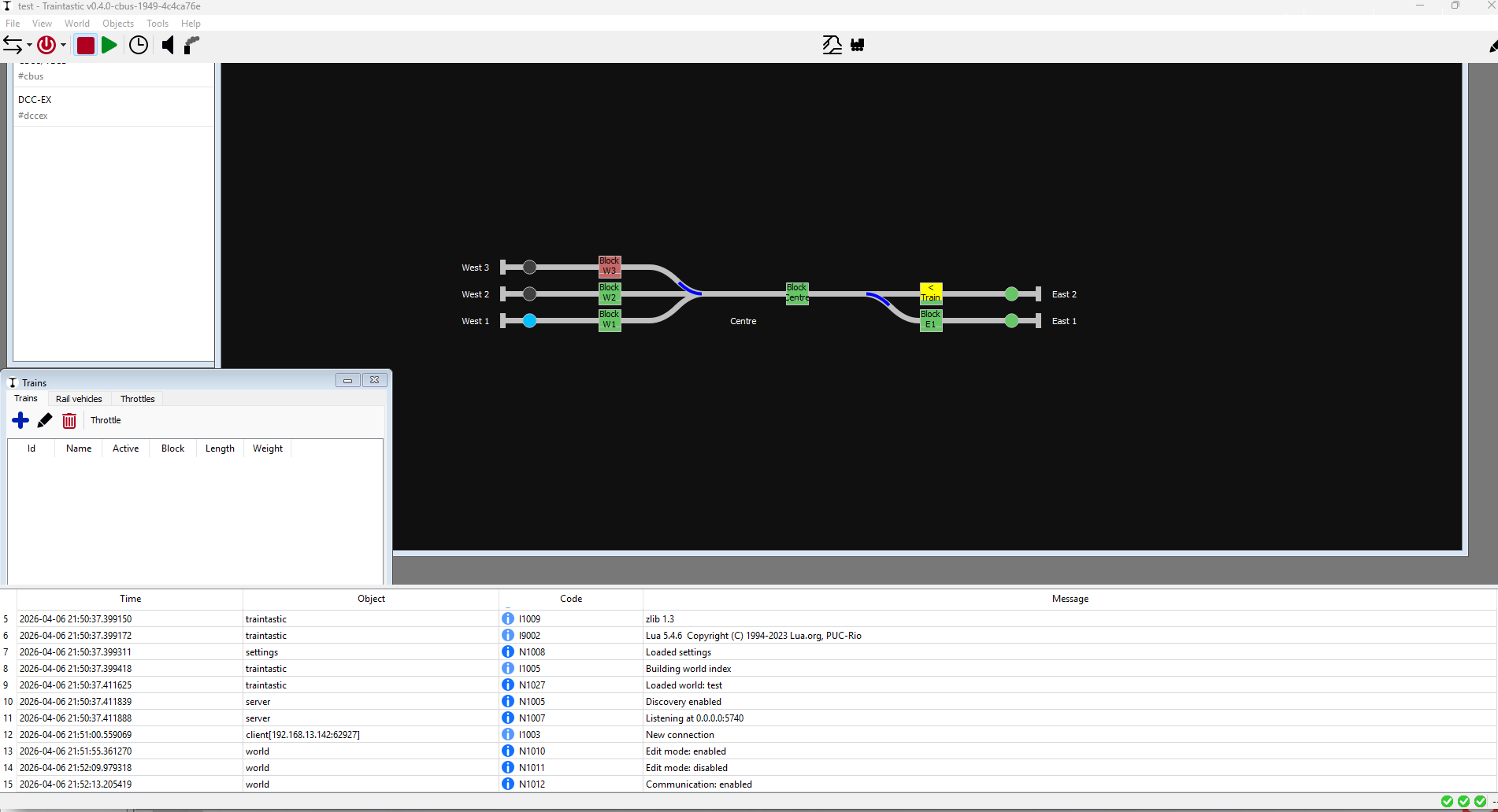

@reinder I’m curious:
I did a stop/start of traintastic and saw this
● traintastic-server.service - Traintastic server daemon
     Loaded: loaded (/usr/lib/systemd/system/traintastic-server.service; enabled; preset: enabled)
     Active: active (running) since Mon 2026-04-06 21:36:39 AEST; 8s ago
    Process: 8098 ExecStart=/opt/traintastic/bin/traintastic-server -d -u traintastic -g traintastic -D /var/opt/traintastic -P (code=exited, status=0/SUCCESS)
   Main PID: 8100 (traintastic-ser)
      Tasks: 2 (limit: 9107)
     Memory: 1.2M (peak: 2.0M)
        CPU: 16ms
     CGroup: /system.slice/traintastic-server.service
             └─8100 /opt/traintastic/bin/traintastic-server -d -u traintastic -g traintastic -D /var/opt/traintastic -P
Apr 06 21:36:39 dcc-master.cook-rd.internal systemd[1]: Starting traintastic-server.service - Traintastic server daemon...
Apr 06 21:36:39 dcc-master.cook-rd.internal systemd[1]: traintastic-server.service: Supervising process 8100 which is not our child. We'll most likely not notice when it exits.
Apr 06 21:36:39 dcc-master.cook-rd.internal systemd[1]: Started traintastic-server.service - Traintastic server daemon.
esp this:
i havent seen that happen elsewhere. It is not a problem just … curious?

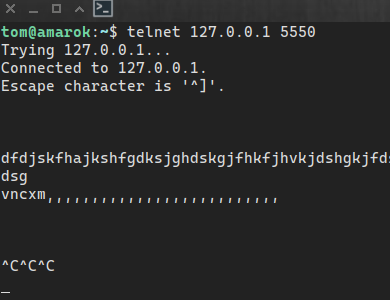

Quick update: as of cbus branch build #1956 Traintatic support a JMRI like hub feature. So now it is possible to run: CBUS config app → Traintastic → CANUSB :slight_smile:

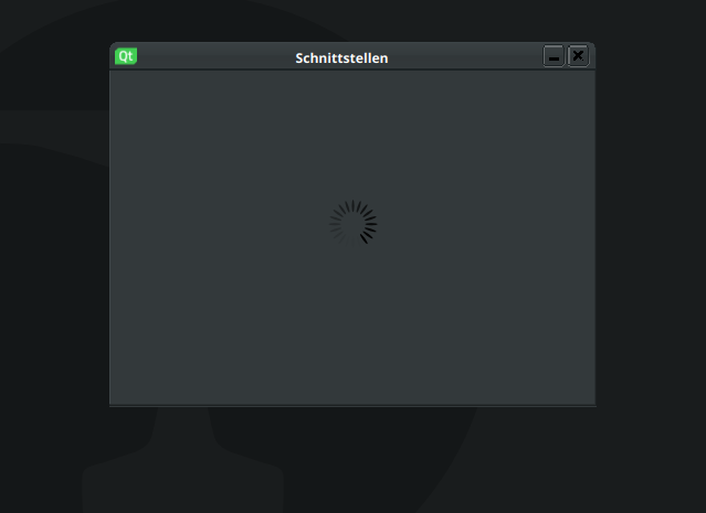

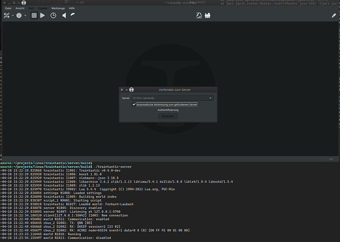

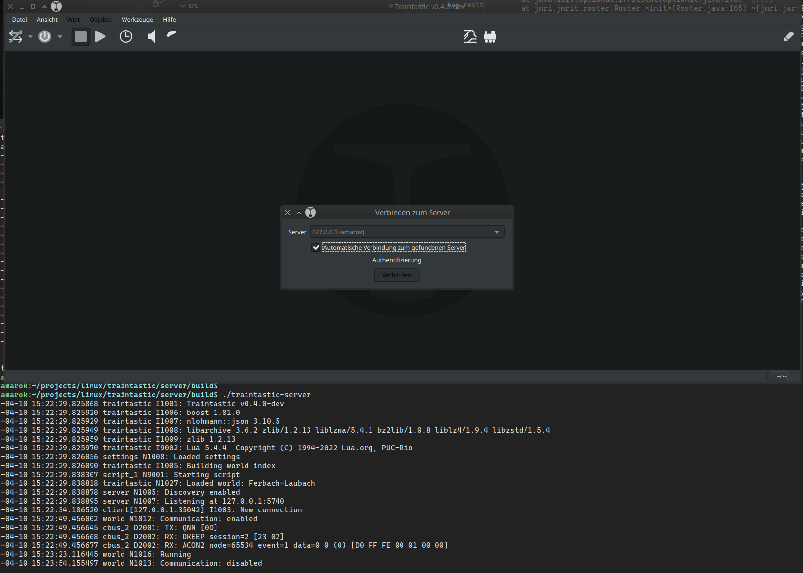

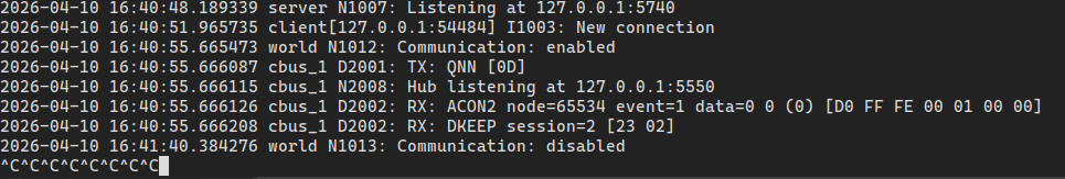

the server hangs after closing the client.
The CPU load is nearly 100% and there is only a kill -9 possible.
grafik
This happens with hub enabled and disabled.
If I try to connect with MMC to 127.0.0.1 5550 I get timeouts, same with DecoderPro.
@DL7BJ just in case: tried your main ip address?
Bind localhost has been occasionally weird to me in other programs when bound to 0.0.0.0 ipv4 & 6
Menno,
0.0.0.0 is not localhost, that is a placeholder for all configured ip addresses. 127.0.0.1 is localhost and I have much stuff, which runs without problems, like the hub of JRMI :slight_smile:
Also the Traintastic Server listen on localhost for the client:
2026-04-10 16:16:46.016544 traintastic I1001: Traintastic v0.4.0-dev
2026-04-10 16:16:46.016596 traintastic I1006: boost 1.81.0
2026-04-10 16:16:46.016605 traintastic I1007: nlohmann::json 3.10.5
2026-04-10 16:16:46.016627 traintastic I1008: libarchive 3.6.2 zlib/1.2.13 liblzma/5.4.1 bz2lib/1.0.8 liblz4/1.9.4 libzstd/1.5.4
2026-04-10 16:16:46.016637 traintastic I1009: zlib 1.2.13
2026-04-10 16:16:46.016646 traintastic I9002: Lua 5.4.4  Copyright (C) 1994-2022 Lua.org, PUC-Rio
2026-04-10 16:16:46.016731 settings N1008: Loaded settings
2026-04-10 16:16:46.016763 traintastic I1005: Building world index
2026-04-10 16:16:46.029116 script_1 N9001: Starting script
2026-04-10 16:16:46.029666 traintastic N1027: Loaded world: Ferbach-Laubach
2026-04-10 16:16:46.029731 server N1005: Discovery enabled
2026-04-10 16:16:46.029748 server N1007: Listening at 127.0.0.1:5740
Sometimes at client start I get this if open the hardware configuration wizard:
A message should actually be displayed here every 5 seconds, because CANCMDB is sending messages.
026-04-10 16:32:31.069480 server N1007: Listening at 127.0.0.1:5740
2026-04-10 16:32:37.919834 client[127.0.0.1:57482] I1003: New connection
2026-04-10 16:33:14.715402 world N1012: Communication: enabled
2026-04-10 16:33:14.716201 cbus_1 D2001: TX: QNN [0D]
2026-04-10 16:33:14.716232 cbus_1 N2008: Hub listening at 127.0.0.1:5550
2026-04-10 16:33:14.716243 cbus_1 D2002: RX: ACON2 node=65534 event=1 data=0 0 (0) [D0 FF FE 00 01 00 00]
2026-04-10 16:33:14.716252 cbus_1 D2002: RX: DKEEP session=2 [23 02]
A telnet connection to 127.0.0.1 5550 hungs, as the server too, if I disable the communication.
To me, it looks like the server is stuck on the port during the read operation, running in a loop.

I wonder what causes the hanging,do you have theTRAINTASTIC_LOCALE_PATH env. var. set? May it is related to missing translations. I don’t see the log message that the Hub hast started listening.
2026-04-10 16:49:45.954898 world N1024: Simulation: enabled
2026-04-10 16:49:48.324456 world N1012: Communication: enabled
2026-04-10 16:49:48.333630 cbus_1 D2001: TX: QNN [0D]
2026-04-10 16:49:48.333679 cbus_1 N2008: Hub listening at 127.0.0.1:5550
2026-04-10 16:49:48.333699 cbus_1 D2002: RX: PNN node=65534 manufacturer_id=165 module_id=83 flags=0x0E [B6 FF FE A5 53 0E]
2026-04-10 16:49:48.333725 cbus_1 D2002: RX: PNN node=65535 manufacturer_id=165 module_id=9 flags=0x0A [B6 FF FF A5 09 0A]
Something like this is expected, then when JMRI or something else connects:
2026-04-10 16:52:18.960992 cbus_1 I2007: New hub connection (127.0.0.1:53822)
