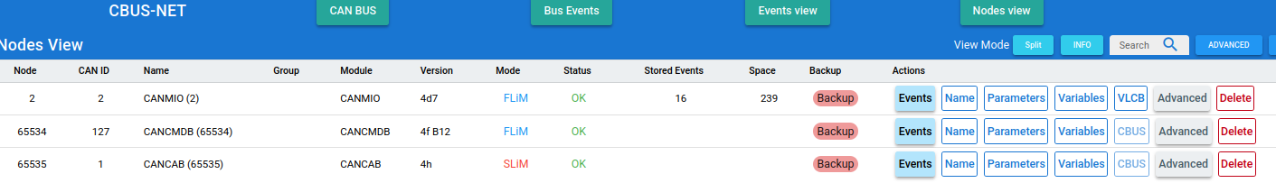

MMC using the hub:
Good to hear, I’ll do a final review of the changes and the merge it to master :slight_smile:
:tada: CBUS/VLCB development is merged into master!
just tested the hub function using MMC and JMRI DecoderPro. I was able to read out the CVs via DecoderPro while connected to the Traintastic hub — works like clockwork!
