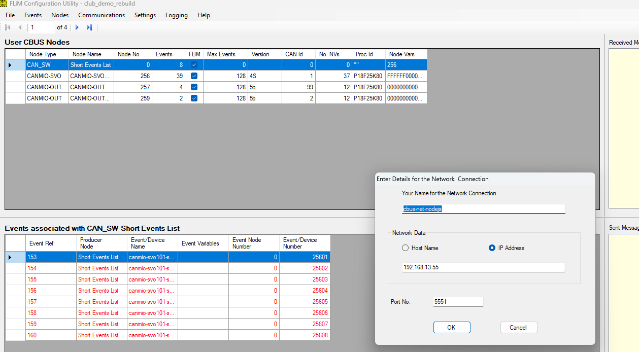

CBUS HUB: seems to be bound to 127.0.0.1 instead of 0.0.0.0
:sob: and socat to set up a hub on 5550 fails → port in use.
Lets grab another port:

Port is open however can’t get it to communicate via a socat redirect and port is bound to localhost instead of a “public” interface"
No obvious config entries in json or abilities to change the behaviour from gui?

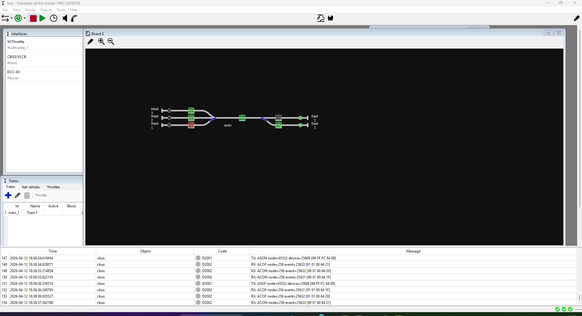

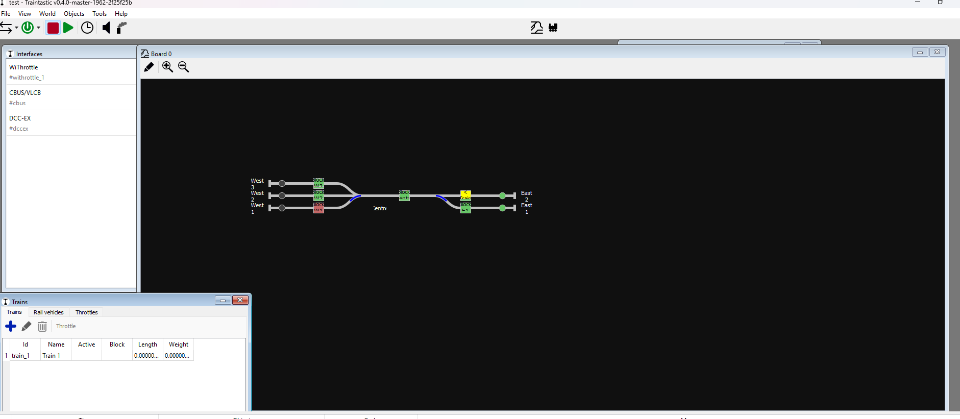

Checking this one train causing the block W2 going yellow with a train:
Note: W2 does not have a train on it / empty block
Lets see if i can delete it from the W2 block:
( right click block, remove train )
Succes but block occupancy icon still looks weird:
( and the train list still contains a train → assuming to be a template? )
Hi Menno,
I just added an option for that: Hub localhost only, enabled by default but you can turn it off :slight_smile: (Requires master build #1963 or later)

Gray means unknown, but the sensor is green, so I think it’s a bug, it is not properly re-evaluated, I’ll look into it.
Yes that is correct, you can create different trains sharing the same loco’s/wagons, but only one maybe active at a given time.

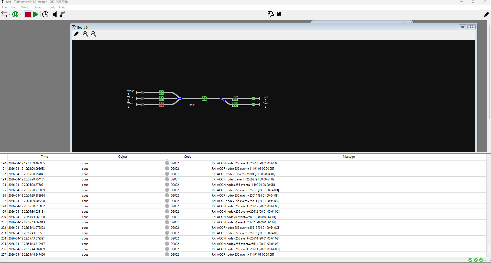

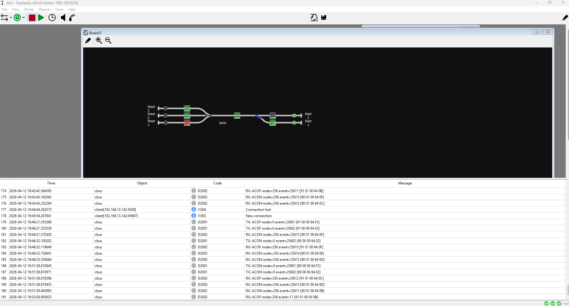

p.s. For the turnout feedback, can you share a part of the communication log where Traintastic sends a turnout switch event, and then receives the feedback event. e.g. for the 3 way turnout switch left/middle/right/left.
Sure:
from right to left:
ACON node 0   ; Event 25602  <- Switch to right W1 Inner (wye)
ACOF node 256 ; Event 25615  <- Sensor Active: canmio-svo101-servo2 Closed
ACON node 256 ; Event 25614  <- Sensor Active: canmio-svo101-servo2 Mid
ACON node 256 ; Event 25613  <- Sensor Active: canmio-svo101-servo2 Thrown
Left → Mid:
ACON: Node 0;  EVENT; 25601 <- Switch to right W1 Outer (wye)
ACON: Node 0;  EVENT; 25602 <- Switch to right W1 Inner (wye)
ACOF: Node 256; EVENT; 25612 <- Sensor Inactive: canmio-svo101-servo1 Closed
ACON: Node 256; EVENT; 25613 <- Sensor Inactive: canmio-svo101-servo2 Thrown
ACON: Node 256; EVENT; 25611 <- Sensor Active: canmio-svo101-servo1 Mid
ACOF: Node 256; EVENT; 25611 <-  Sensor Active: canmio-svo101-servo1 Mid
Looks like Traintastic seems to miss an event or two?
For each servo i expect the sequence:
From Thrown [ ACOF ] → mid [ ACON/ACOF?? ] → close [ ACON ]
I will have another look after i had my dinner and fire up JMRI with a filter… Strange.

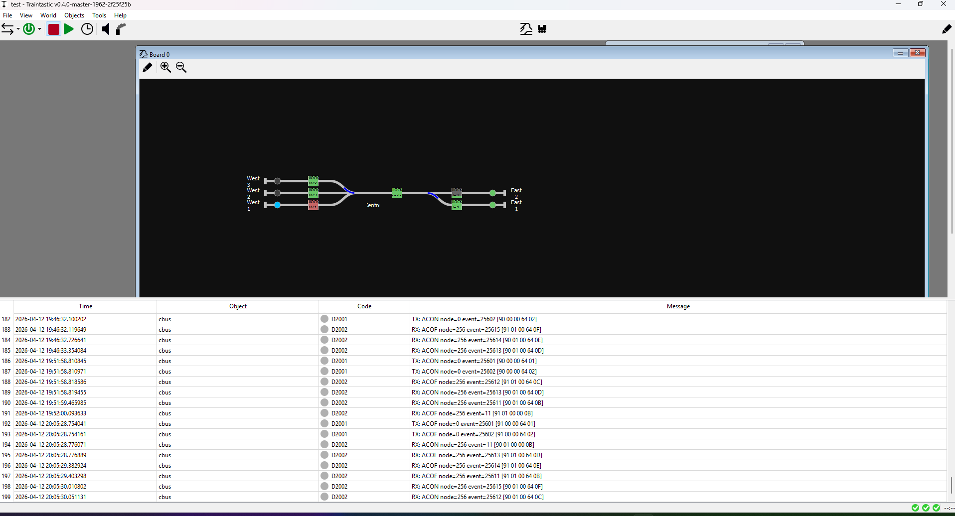

For confirmation see screenshot. PS you should have my config / excell sheet ( csv ) with all my events in case i copy it down wrong :rofl:

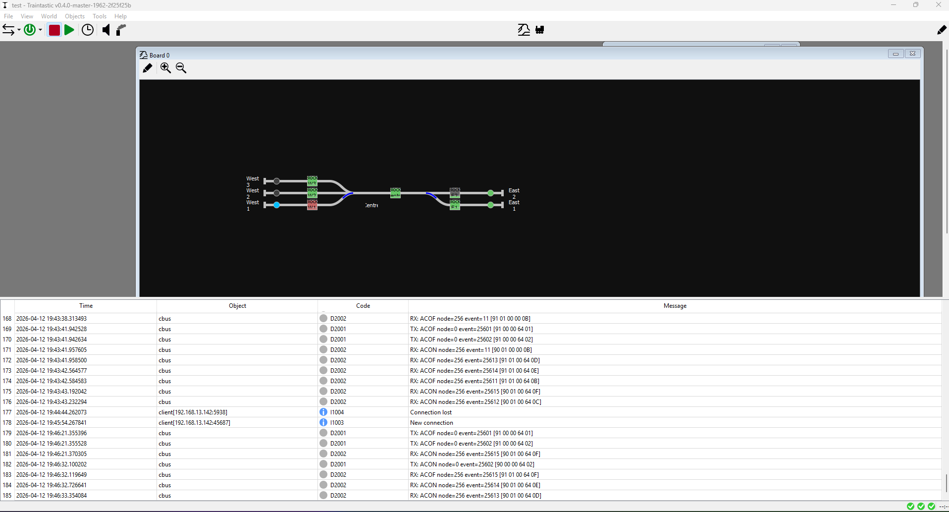

Mid → right:
 ⚡ root@dcc-master  /var/opt/traintastic/log  grep "2026-04-12;20:05"  traintastic.txt
2026-04-12;20:05:28.754041;cbus;D2001;TX: ACOF node=0 event=25601 [91 00 00 64 01]   <- Servo1 Wye Outer
2026-04-12;20:05:28.754161;cbus;D2001;TX: ACOF node=0 event=25602 [91 00 00 64 02]   <- Servo2  Wye Inner
2026-04-12;20:05:28.776071;cbus;D2002;RX: ACON node=256 event=11 [90 01 00 00 0B]    <- Servo1 MID
2026-04-12;20:05:28.776889;cbus;D2002;RX: ACOF node=256 event=25613 [91 01 00 64 0D] <- Servo2 THROWN
2026-04-12;20:05:29.382924;cbus;D2002;RX: ACOF node=256 event=25614 [91 01 00 64 0E] <- Servo2 MID
2026-04-12;20:05:29.403298;cbus;D2002;RX: ACOF node=256 event=25611 [91 01 00 64 0B] <- Servo1 MID
2026-04-12;20:05:30.010802;cbus;D2002;RX: ACON node=256 event=25615 [90 01 00 64 0F] <- Servo2 Closed
2026-04-12;20:05:30.051131;cbus;D2002;RX: ACON node=256 event=25612 [90 01 00 64 0C] <- Servo1 Closed

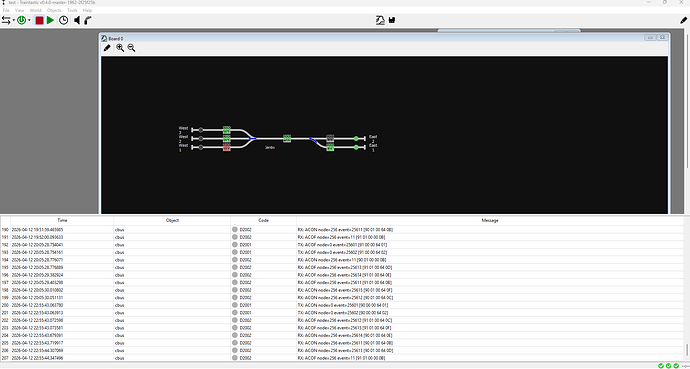

From right to straight:
 ⚡ root@dcc-master  /var/opt/traintastic/log  grep "2026-04-12;22:"  traintastic.txt
2026-04-12;22:55:43.063780;cbus;D2001;TX: ACON node=0 event=25601 [90 00 00 64 01] <- anmio-svo101-servo1: W1 outer (wye)
2026-04-12;22:55:43.063913;cbus;D2001;TX: ACON node=0 event=25602 [90 00 00 64 02] <- anmio-svo101-servo1: W2 inner (wye)
2026-04-12;22:55:43.072598;cbus;D2002;RX: ACOF node=256 event=25612 [91 01 00 64 0C] <- Sensor Inactive: canmio-svo101-servo1 Closed
2026-04-12;22:55:43.073581;cbus;D2002;RX: ACOF node=256 event=25615 [91 01 00 64 0F] <- Sensor Active: canmio-svo101-servo2 Closed
2026-04-12;22:55:43.679391;cbus;D2002;RX: ACON node=256 event=25614 [90 01 00 64 0E] <- Sensor Active: canmio-svo101-servo2 Mid
2026-04-12;22:55:43.719917;cbus;D2002;RX: ACON node=256 event=25611 [90 01 00 64 0B] <- Sensor Active: canmio-svo101-servo1 Mid
2026-04-12;22:55:44.307069;cbus;D2002;RX: ACON node=256 event=25613 [90 01 00 64 0D] <- Sensor Active: canmio-svo101-servo2 Thrown
2026-04-12;22:55:44.347496;cbus;D2002;RX: ACOF node=256 event=11 [91 01 00 00 0B] <- Sensor Inactive: canmio-out102-E2 End of Track
256-11 Should be unrelated → ghosts?

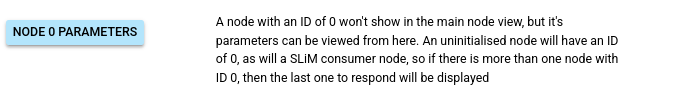

Menno, I’m unsure whether node number 0 is correct, because I believe I read that in FLiM mode node numbering should always start at 1.
The CBUS specification says this:
As all nodes need to accessed by the configuration tool, both producers and consumers must have node
numbers. These are a 16 bit range (1 to 65535) and would normally be allocated by the configuration
software. Nodes (modules) can be given names linked to their NNs.
NN of 00 00 is a special case reserved for SLliM consumer nodes and configuration software.
It might be worth trying to avoid node number 0.

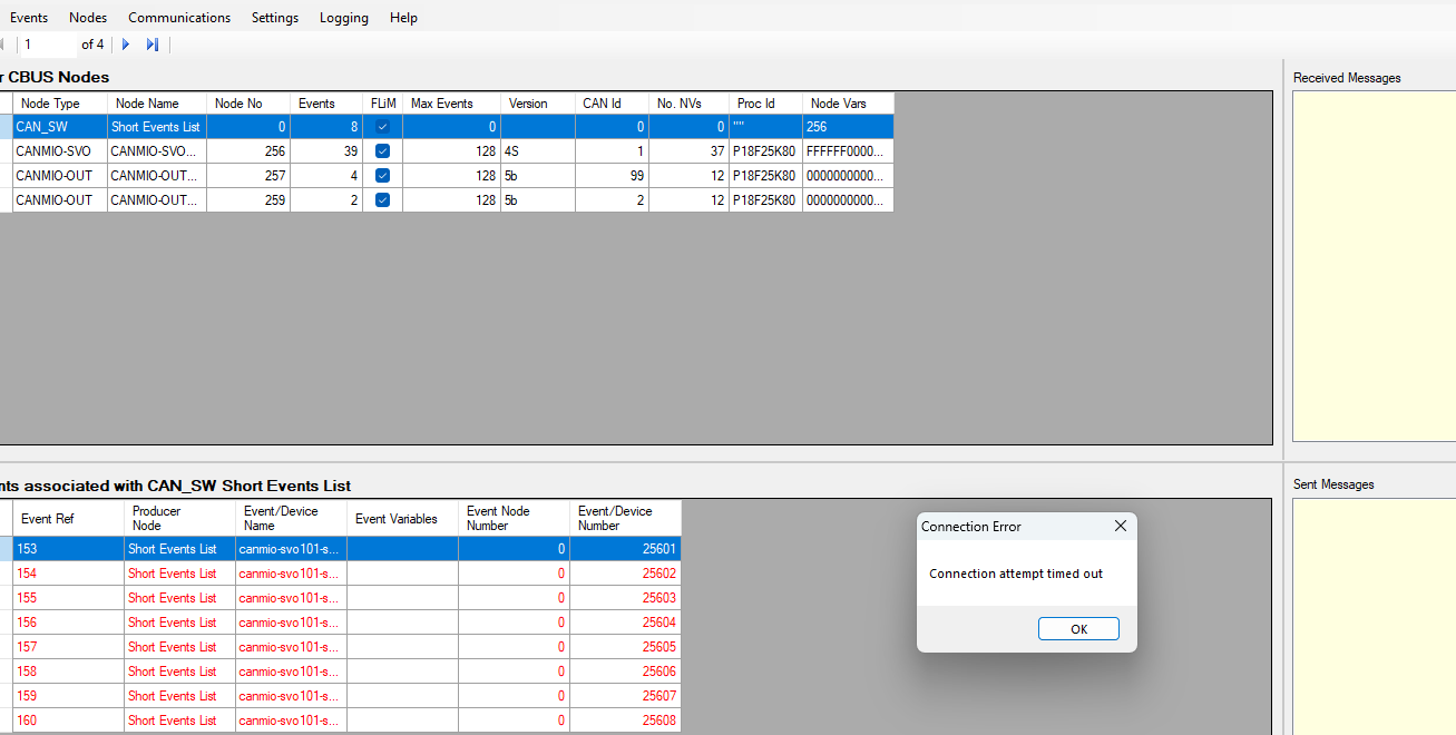

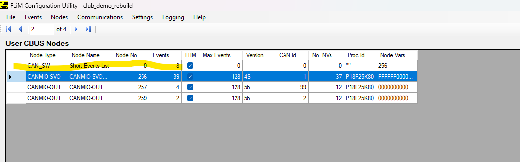

Interesting… Especially since i do not remember me having the ability to configure things. FliM config Screenshot:
But the software node in FliM and/or JMRI Config may be the exception?
Note: i did set up the servo moves as an event initiated by the Software node
actually
… ye software node

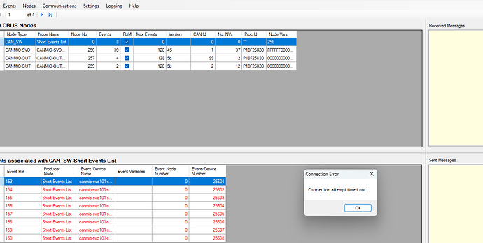

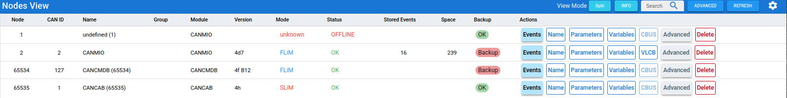

Okay, I use only MMC, there is no “software node”.
(the node 1 is a not connected CANMIO)
But there is a configuration option, which I can’t use, because I have no node 0. I could reset a node to initialize, than I get a popup for this node.
Traintastic has also no node number 0. I don’t know why Flim needs this.
How am I supposed to understand this? A servo is triggered by an event, or by Traintastic, right? I urgently need to build a CANservo!
Well FliM does have node 0 as it’s default node.
I set up an event on node 0 and have my canservo taught that event.
Traintastic triggers node 0’s [ software node ] event
Reason: i might have been relateively early with my canservo build and FliM has been in need of attention for a while.
It is not impossible that the Current FliM [ OR MMC (!) ] may have newer/better options.
FliM did not have ways of direct triggering the event to move the servos when i was looking.

page 8 has the software node at 0.

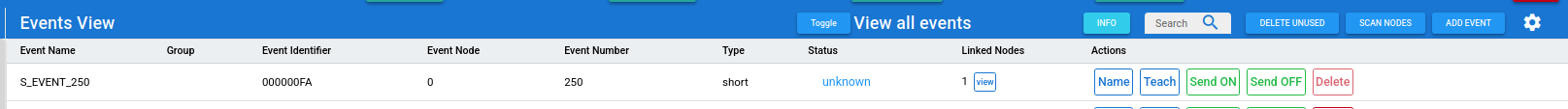

Menno, that means you couldn’t use the canservo without FliM?
If I set up a short event in MMC, it is listed in the event list with node 0:
But there is no real node 0 and short events are consumed by all nodes where the short event is configured.
socketServer: ACCESSORY_SHORT_ON {"nodeNumber":0,"deviceNumber":250}
mergAdminNode: eventIdentifier : 000000FA
mergAdminNode: EventSend : {"eventIdentifier":"000000FA","nodeNumber":0,"eventNumber":250,"status":"on","type":"short","count":1}
Why Traintastic don’t trigger the event for CANSERVO directly?
Could it be, that Traintastic also consumed the short event?
IMHO any canv* series node is flim only

Traintastic short events
If Traintastic sends a short event it uses the CANUSB/CANEther node number as node number. Technically the node number is ignored for short events, so it doesn’t really matter actually, but if I remember correctly the specs stated the the senders node number should be set, so it is possible to tract who sent it.
CANUSB4 has no node number, it’s a transparent interface. Traintastic should use for short events the node number 0 as it MMC does.
socketServer: ACCESSORY_SHORT_OFF {"nodeNumber":0,"deviceNumber":250}
mergAdminNode: EventSend : {"eventIdentifier":"000000FA","nodeNumber":0,"eventNumber":250,"status":"off","type":"short","count":2}
messageRouter: GRID_CONNECT_SEND ASOF (99) Node 0 Device Number 250
socketServer: EVENTS sent
I think it’s the same with CANETHER, but CANETHER has some NV’s, CANUSB4 not.
I will test later some short events with Traintastic.
